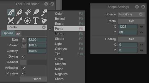

At first I was wondering how this Clone Stamp custom brush is different than the built-in "Panto" mode ?
But one thing I like about this Clone Stamp tool is that the preview of the brush is more clearly defined.
Other than that it seems to function the same as the Panto mode.
I notice that the default size of the Clone Stamp tool is set at 400. I would usually need to make that somewhat smaller.
Screen Shot 2021-04-09 at 8.35.06 AM.jpg (31.07 KiB) Viewed 27753 times
