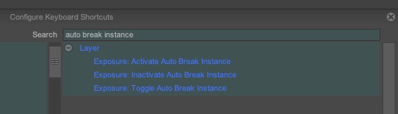

Joost wrote: 13 Apr 2021, 14:29 Or would it maybe be possible to make an action that turns the auto break function off every time I select the transform tool, and when I grab another tool, it automatically toggles "on" again?
I'm not sure how to create that sort of action, but you could assign a keyboard shortcut to Toggle Auto Break Instance, which would be a quicker way to turn it on and off than having to click the button in the layer panel.
Screen Shot 2021-04-13 at 9.50.39 AM.jpg (16.29 KiB) Viewed 11203 times

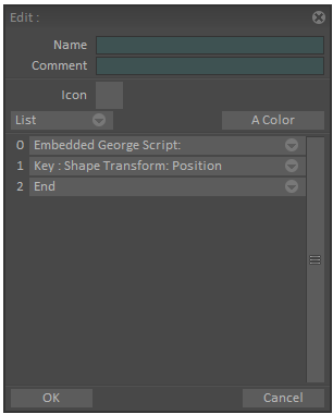

Hmm, seems straightforward to me - there are several options:
1. Create a new Action. Add first command with Sven's George script. Add second command with Set Keystroke > Shape Transform > Position.
Voila - you have an action that will turn off the autobreaking and choose the transform too. Assign a shortcut to it if you want.
2. I personally use Wacom express keys a lot. I have one dedicated for the Transform tool. You can combine any chain of shortcuts on one express key, so that if you press it it would both execute Sven's Autobreak Off script and select the Transform tool.
Thanks a lot! This really helps.
