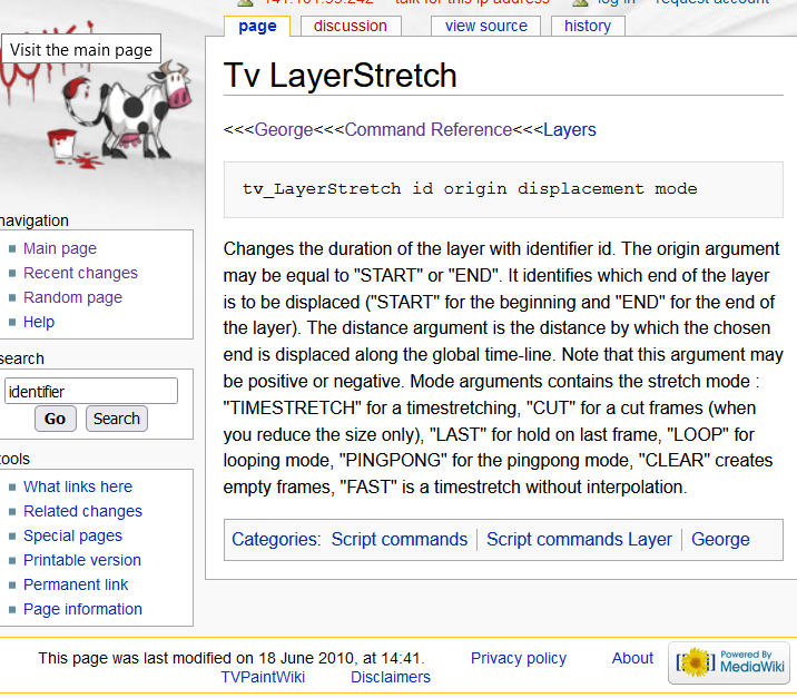

trying to built a custom action using Markus approach
i get stuck at trying to stretch the layer:
i think i should use this command: tv_layerstretch
but the wiki does not give me example of how to use it...
