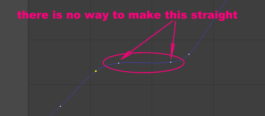

Also it would give much more control if we could have separate graphs (speedprofiles) for each of the keyable FX atributes(position, angle, value, percentage... etc..)
And control of the shape of the speedprofile itself is also primitive.
I would like to have splinehandles, that would give us the option to make parts of the profile 100% straight.

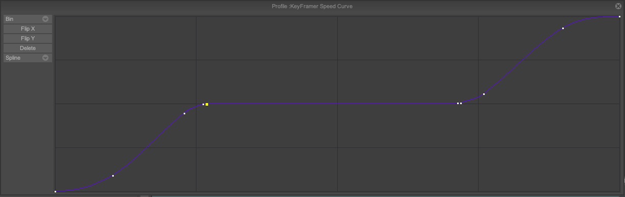

Re: FX Stack and the Speed Profile
peter,
try stacking three dots on each end of the wanna-be straight line. Repositioning any 3 point stacked group is figgit-y but it is do-able to refine timing and curves.

Yes, that's the only way I've ever been able to get a straight line, although usually I can get what I want with one extra point inserted on each end of the held (flat line) portion.
