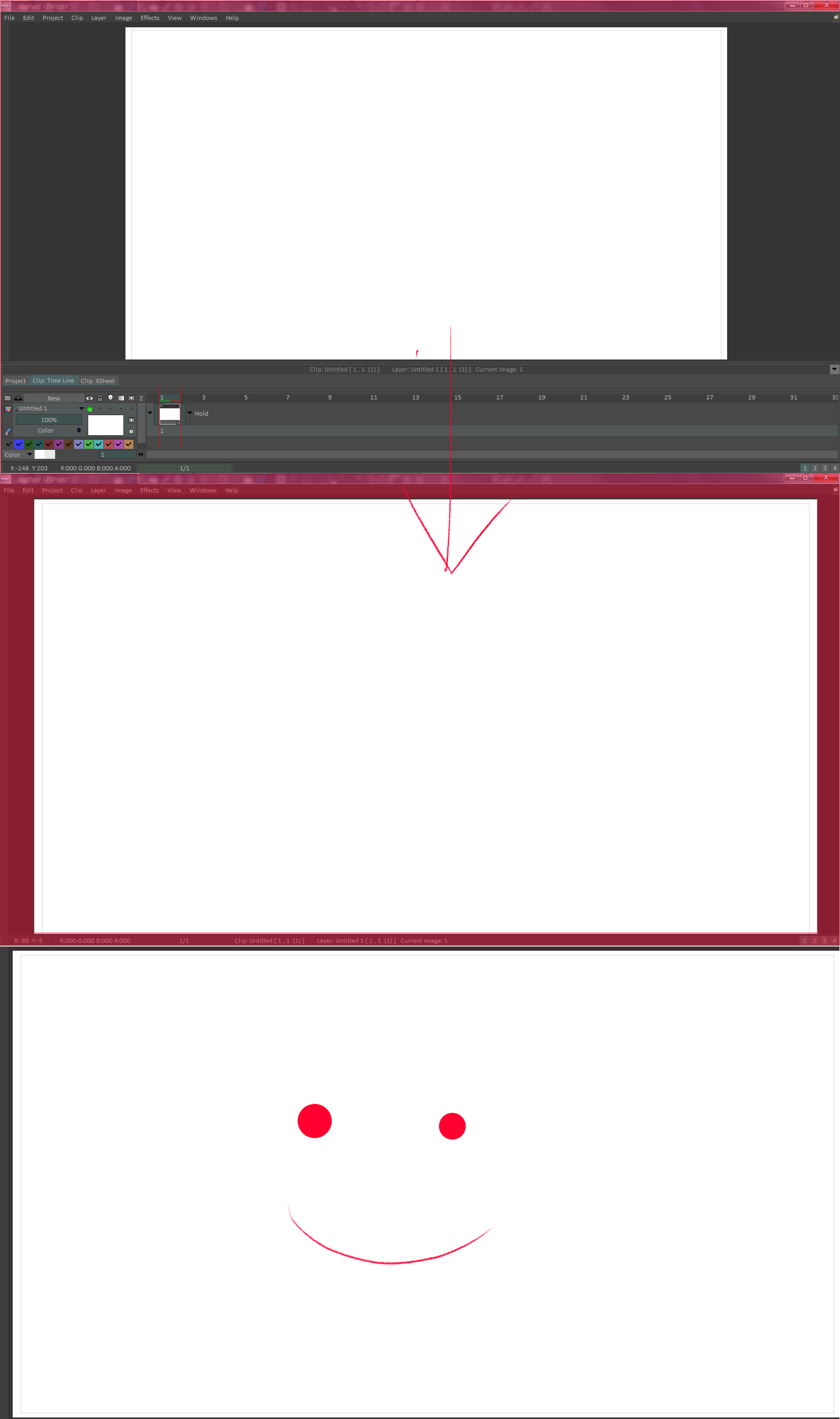

Sorry idk if this is the correct section,
I made a script using ahk to -> "fake" FullScreen , Pan , Zoom in and Out like Photoshop
Comment if it worked
Space + LButton : pan
Ctrl + Space + LButton : Zoom in-Out
F:: Fake fullscreen on / off
1) DOWNLOAD :
a) AUTOHOTKEYSCRIPT https://www.autohotkey.com/download/
b) THIS SCRIPT (OR COPY AND PASTE ON NEW AHK SCRIPT)
CHANGE KEYBOARD-SHORCUTS ON THIS AHK SCRIPT , OR ON TVPAINT TO MATCH THIS SCRIPT KEYBOARD-SHORCUTS BELOW
(not this hotkeys, this are from ahk.exe)
