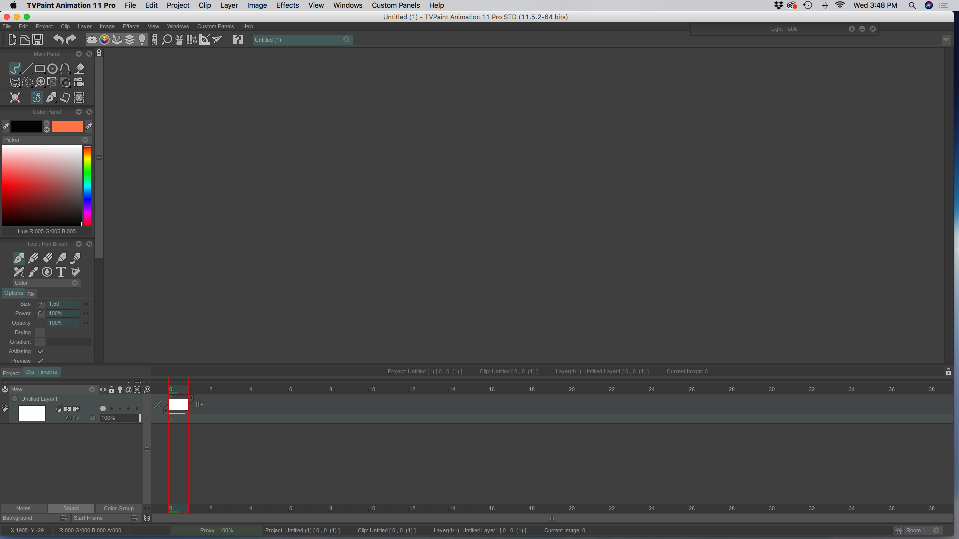

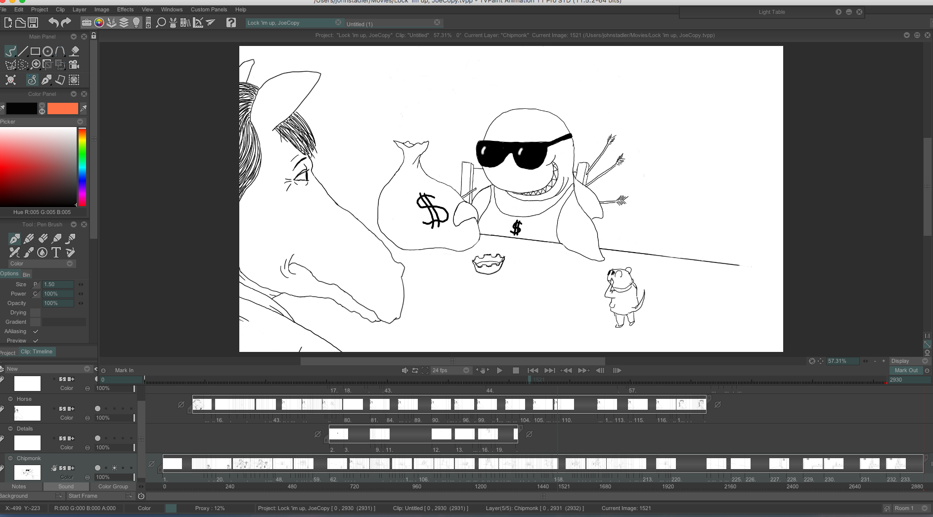

Hopefully, this is an easy fix. Somehow, something happens to disconnect the linkage between the display area (where I draw) and the layers area beneath it. So, when I press "0" to toggle between the two areas, the layers area shifts correctly but the display area stays the same and unlinked. I assume this happens because of unintentionally clicking something. My attempts to correct this have been unsuccessful. Maybe the enclosed screen shots will help make the issue clearer. Any thoughts?

Hello, this must come from the fact that your drawing space is undocked. Does clicking on the expand icon solve the issue?

Yes, that's it! Thank you very much, Dean. And best wishes for a good new year to you and everybody else.
