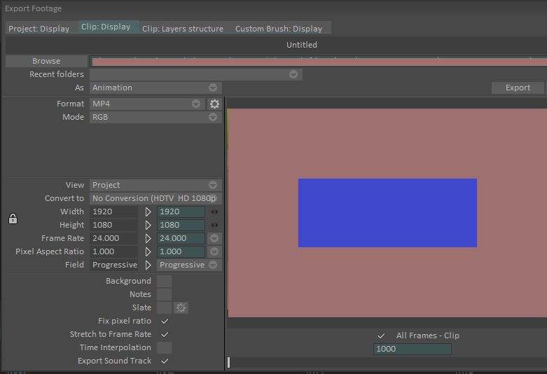

If i want to transpose this export settings
to george code, should be :

In other way, tv_ProjectSaveSequence equal to Export Footage > Clip:Display ?

hum, not at all...still a question...because if i run this script i've got en .mov but is totaly white or black with NaN value...
same with mode=1015
