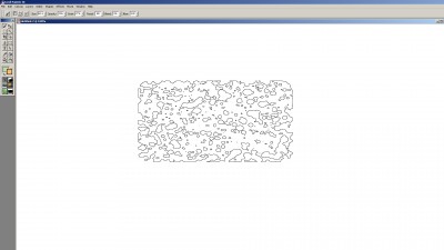

This was from Hisko Hulsing, regarding a brush he and Peter Wassink recreated in TVPaint.
this brush
"I made a screenshot of the Painter brush, and imported the image in TVPaint and added paper and pressure for the opacity.
I'm working with the brush right now and it feels even better than the one in Painter."

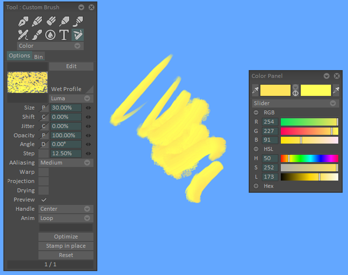

Re: Brush Creation Help
Thank you for the advise, I really like what the luma setting allows to do!
I just have a tiny problem, that switching from alpha stamp to luma, makes my brush very transparent. I don't really understand why tho... Any pointers? The brush I'm speaking about is this one. I'd really appreciate it, thank you!
