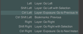

As explained on the other topic created by Jmew : you have the possibility to choose.
Use "Layer: Go left" and "Layer: Go right" if you wish to navigate freely. (1)
Use "Go to next instance" and "Go to previous instance" to move between existing instances. (2)
By default with the latest TVPaint versions, (1) are assigned to left and right arrow and (2) are assigned to ctrl+left / right.

However if you already have an existing keymap it is not overwritten and thus, the new default keyboard shortcuts can't be set.
