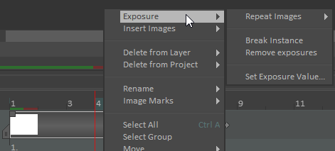

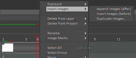

  • Reorganisation of Timeline options when right-clicking:
    Spoiler : Timeline options :
    v11.5.2:
    v11.5.3:

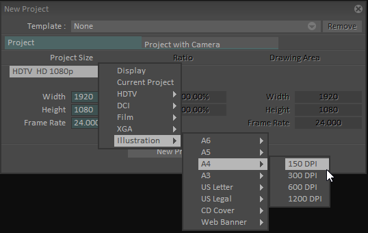

  • Illustration presets have been updated with DPI informations:
    Spoiler : :
    v11.5.2:
    v11.5.3:
