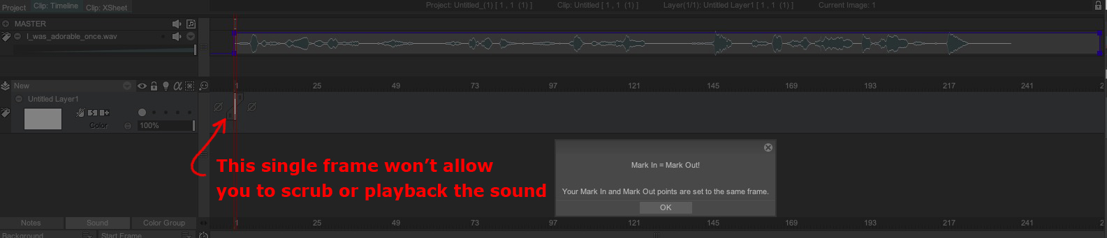

Load Sound pop up menu says"mark in=mark out!"
Post by kabecio »
This is the first time Ive tried to load sound so that can animate to the sound. I can see the track and the wave form but a pop up menu keeps coming up that says "mark in=mark out!" and it will not allow me any further moves. What should I do? Im using TVP 11 standard.
Re: Export "mark in - mark out" BUG

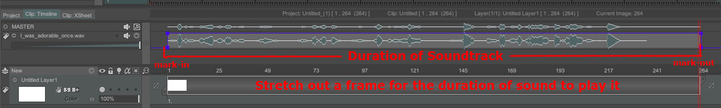

How long is your sound track ? (in frames?) Let's just say your sound track that is 11 seconds long. That would be 264 frames. Before you can playback the sound you will need at least one instance (frame) that is exposed on the Timeline for 264 frames. That is the mark-in/mark-out the program is looking for so it can playback the sound and let you scrub it.

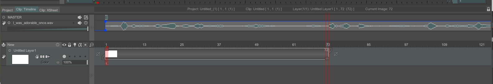

If you wanted to only hear 72 frames of the 264 frame sound , drag out the layer on the timeline for only 72 frames.
