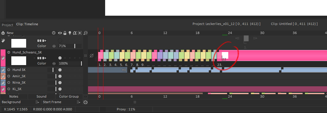

Currently it looks like this

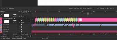

But it would be great if there would be a better indicator which frames get looped. Something like this
Or maybe even a bar, which in and out points you could adjust with your cursor
I don't know if any of this would be possible with the current core, but it would be great. However, thank you for this feature again.
Repeat Image Feature set range

your suggestions are great, though i'm not sure how hight they curently would fit.... priority wise.
As i was thinking about them, and also reading the request for improvement of the progres profile.
i thought maybe we could try and think bigger(=further into the future.)
instead of adding yet another interface element on top of the rest, rethink the way the timeline displays both drawings and effects.
we could introduce FX layers that contain the timerelated elements of the fxstack like the FX-keys but with integrated spline graphs
then the repeat image function could also be displayed there and it could look like you proposed in that third image, but displayed in the fxlayers portion of the layerpanel.
ah well nevermind... i think i'm now proposing to add aftereffects into tvpaint...

Haha I thought "Oh great idea", till I read this sentence.Peter Wassink wrote: ↑27 Jul 2021, 11:15 ah well nevermind... i think i'm now proposing to add aftereffects into tvpaint...
But at least have a better indication of the repeated frames would be really nice. And you're right maybe nothing for V11 but maybe something to consider for V12
