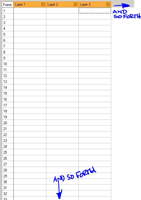

"I have a dream"....traditional X-Sheet. (Vertical time line) Same functions as horizontal time line...Just on the right side corner.....
- Xsheet.JPG (48.02 KiB) Viewed 36618 times

Hello
I might have posted a "wish" in the wrong place.
I wanted to ask if anybody can let me know if the "X-sheet" (Vertical timeline) function is actually working in the updated version of TvPaint?
I ask because I am the happy owner of Tvpaint 10,5 and the "X-sheet" is not (as far as I can see) working!??
It seems like it was put in but never finished..?
All the best.
A.

Re: Timesheet
The X-Sheet in TVPaint (10 - 10.5 - 11 - 11.5) works, but in (my opinion) a very counter-intuitive way that will especially vex traditional pencil-on-paper animators coming from using hand-written paper X-sheets. There's been a lot of discussion about it over the years. I got to the point where I stopped caring about it and just embraced the horizontal timeline format which does everything I need it to do. At some point I hope the developers will look at revamping the vertical X-sheet format , but as it is now it is pretty much unusable (imo).
Here is one of the previous discussions about it: https://www.tvpaint.com/forum/viewtopic.php?f=21&t=8116
I should add that the X-Sheet in TVPaint is something different than the Timesheet custom tool posted at the beginning of this topic, which is specifically made for Japanese production pipeline.
But , you mean this , right ? --

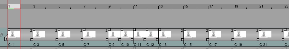

Mads was (is?) a real TVPaint power user. He has contributed many very useful custom panels over the years and used to be active on the beta testing team, but hasn't been around here much since 2018. I hope he is well and I hope he still checks in here from time to time (?). I still use his custom panels every day, especially his Tracker Panel.
Mads' Tracker Panel performs several useful functions as described in the first post here: https://www.tvpaint.com/forum/viewtopic.php?f=11&t=7132 , but one thing I use it for constantly is to Auto-rename the instances on my Timeline so they always match the frame number , like on a traditional X-Sheet where if you have animation ON 2's, the numbering of the drawings is 1, 3, 5, 7 , 9, 11, 13, 15, 17, 19, etc.
Mads' Tracker will respect the exposure of the drawings (instances) and will number the instances to match the frame number . For example, if you have a series of drawings partially exposed ON 1's and partially exposed ON 2's , by default TVPaint will simply number the instances as 1, 2, 3, 4, 5, 6, 7, 8, 9, 10, 11, 12, 13, 14, 15 ,16,17,18,19,20,21,22, consecutively , even if some of the drawings are exposed ON 2's , but Mads' Tracker Panel automatically numbers them correctly as:
1 _ 3 _ 5 _ 7 _ 9 ,10, 11, 12, 13 _ 15_ 17_ 19_ 21_ , etc.
(in this example , the first four instances being exposed ON 2's , the next four instances exposed ON 1's , then the next five exposed ON 2's ... )

Yes, I love using that Instance Tracker script by Mads Juul . I think the default way of renaming instances in TVPaint should be like Mads' script.
