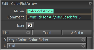

Re: Auto Pick color - choose the source
In a button?
or GEORGE command?
