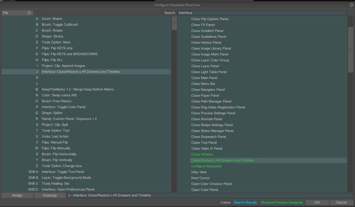

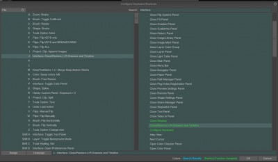

If you're looking to declutter the interface so you only see the main drawing canvas area you can set a shortcut key for the action 'Interface:Close/Restore L+R Drawers and Timeline' . I have mine set to the J key , but you can set yours to any available key for the shortcut. Pressing this key instantly hides the Left and Right storage drawers and the timeline , so all you have is the drawing canvas (and if you want a floating panel with a small set of your most used brushes and erasers ). Press the key again brings up the Drawers and Timeline again.
