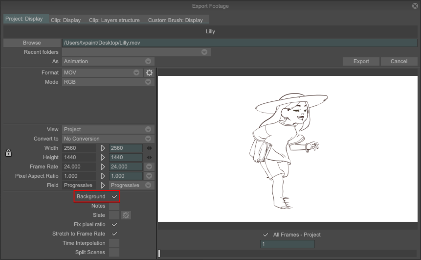

I have just tested this on the same OS (macOS 12.2.1) and can't replicate your issue.
Are you sure you had the "Background" option checked in the export panel:

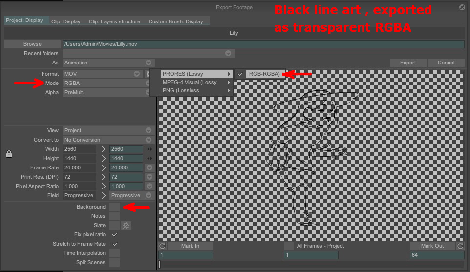

Re: 11.5.3 Export ProRes .mov results in no video.
Keep in mind , that if exporting black line art layer as ProRes .mov in RGBA (transparent) mode with Background deselected , the black lines will be viewed in a video player as black on black (hence invisible , even through the lines are actually there) . You won't see the exported line animation until you have composited it over a non-black color background. It's different than exporting black lines to RGBA (transparent) PNG or TGA where you will be able to see the black line art.

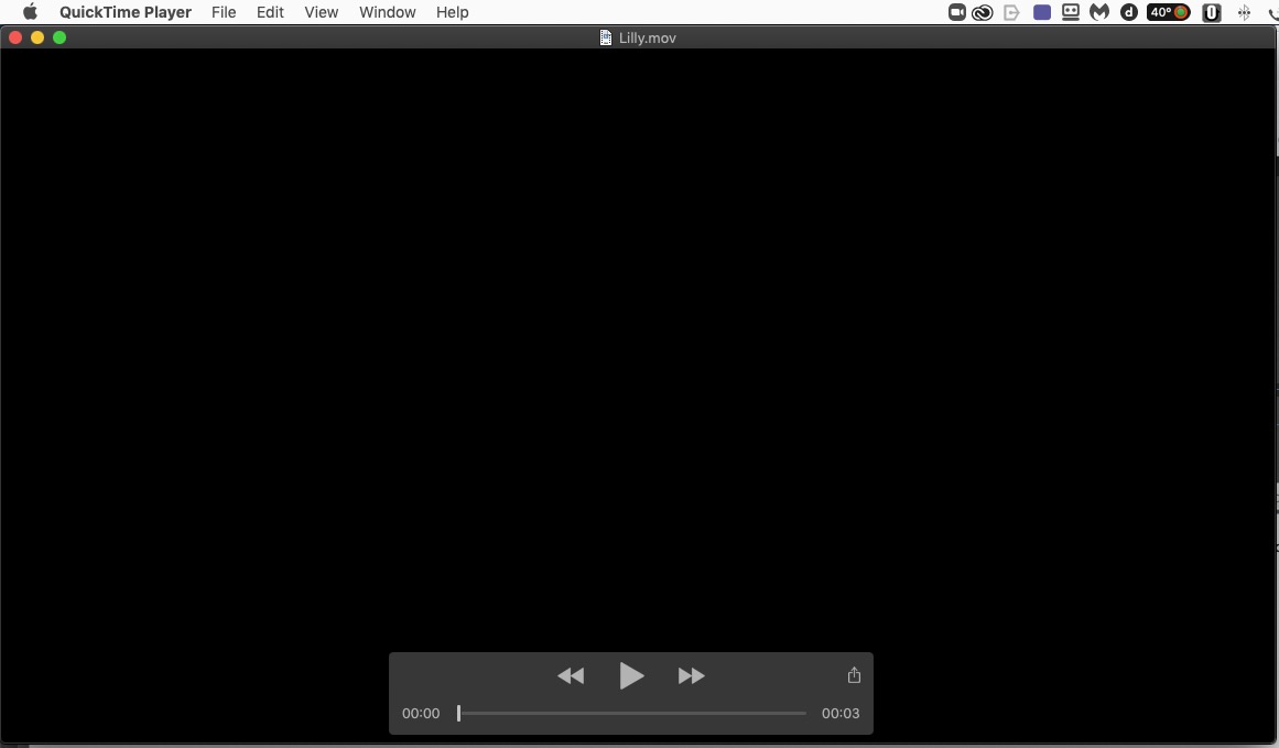

This is what you see if you open the .mov in Quicktime Player (black lines on a black background) -
Screen Shot 2022-04-08 at 11.02.48 AM.jpg (39.2 KiB) Viewed 4418 times
The line art is there , but you can't see it if you open the .mov in Quicktime player or VLC player.

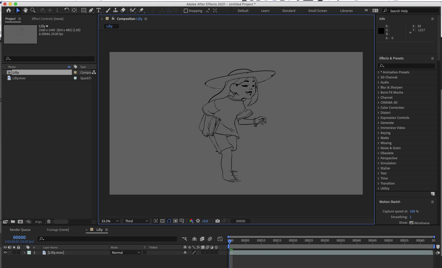

However, if you import that .mov file into After Effects you can see the black line art if your background in AE is set to something other than black.

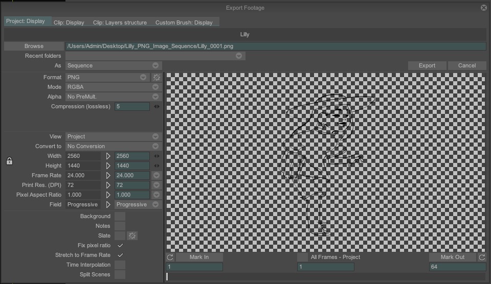

The same images exported from TVPaint as PNG or TGA with transparency (RGBA mode) can be seen when you open the image sequence in Preview or other image viewer.
Exported from TVPaint as PNG or TGA with transparency -
(click image to view at full size)

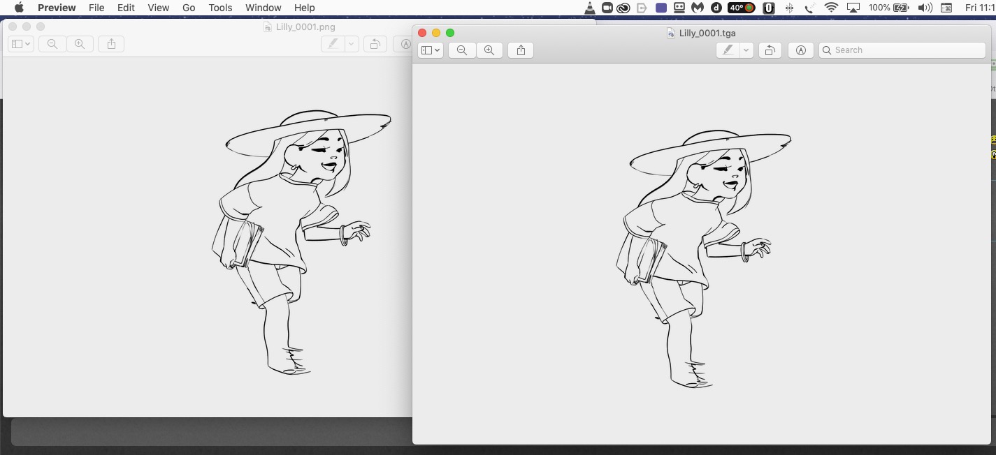

On the PNG or TGA images the black line art will show up when opened in Preview:
