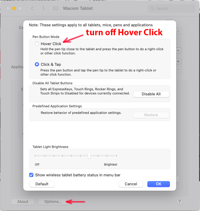

Soom wrote: 19 Jul 2022, 23:26
On a Mac (it's the same machine with NVidia card and 2 displays) the last Wacom driver that works for me is 6.3.37-3. If I update it to any later driver,
when I hover-right-click, I get a 100 percent size/power erased lines. This is not workable.
The only way I was able to get that hover erasing problem to go away was to uncheck Hover Click in the Wacom Eraser Options.

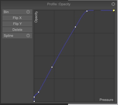

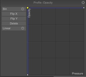

I'm on Mac, running the latest Wacom driver / Mac OS, I've had the same behaviours of the hover-right click to erase. I've found that instead of having opacity set to constant, setting it to pressure with the curve profile like this is a work-around to stop hover click from erasing things:
Screenshot 2022-07-21 at 09.23.02.jpg (16.43 KiB) Viewed 12113 times
and similarly i use something like this if the pressure curve begins anywhere above 0:
Screenshot 2022-07-21 at 09.20.19.jpg (20.74 KiB) Viewed 12113 times
I've also found that with even this method, if you press the pen down once while hover clicking to begin to erase, then lifting the pen up without releasing right click, the pen will continue to erase whilst hovering.

D.T. Nethery wrote: 20 Jul 2022, 00:50 The only way I was able to get that hover erasing problem to go away was to uncheck Hover Click in the Wacom Eraser Options.
Hi Christopher, the Wacom setting that D.T. Nethery pointed out sounded to us like an explanation. Yet it seems Wacom seemed to set "Hover Click" by default, so it's a bit annoying to us. But at least, we have a better understanding regarding this unexplained behaviour in TVPaint. We need to get in touch with Wacom to handle the "Hover Click" properly.
Well, that's exactly not an option for me because I am using the Hover-Click all the time. I don't mind the little minimum pressure lines, but I cannot work if it's erasing at 100% force all the time that happens on Mac with the later driver.

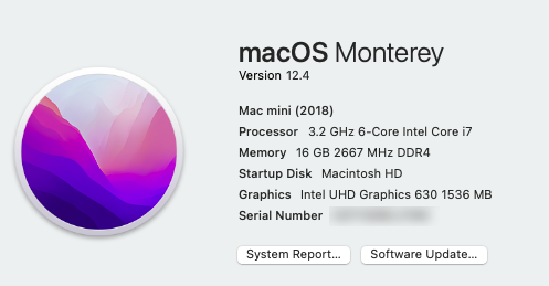

Soom wrote: 21 Jul 2022, 20:12 I myself am working on an Intel machine, but the thing is that I am going to upgrade it the latest OS probably soon and I am afraid that older drivers will not work anymore...
If it's any help to you , I'm running MacOS 12.4 Monterey on a 2018 Mac Mini (Intel) using older Wacom driver 6.3.38-3 (with a Wacom Cintiq 21UX 2nd Gen.)
These specs:
Screen Shot 2022-07-27 at 9.25.44 AM.png (51.2 KiB) Viewed 11969 times

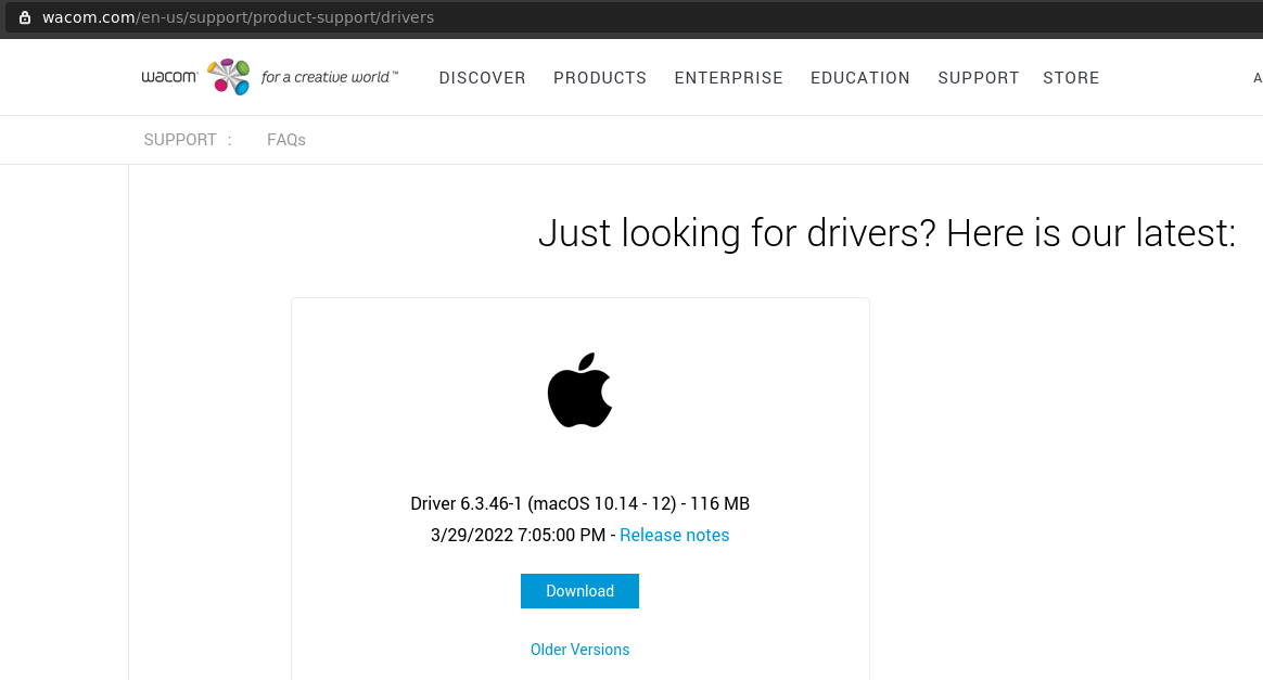

The latest Wacom drivers supports from Mojave to Monterey :
Capture d’écran_2022-07-27_16-00-04.png (46.97 KiB) Viewed 11964 times

Xavier wrote: 27 Jul 2022, 14:09
Except that driver 6.3.46-1 does not support all older Wacom hardware, so if you are like me, trying to squeeze a few more years out of a 12 year old Wacom Cintiq 21UX, the end-of-the-line is driver 6.3.38-3 ... or maybe driver 6.3.40-2 if you don't use Express Keys , because a Known Issue for driver 6.3.40-2 is "When activating a keystroke assigned to a button (holding down an ExpressKey or pen button assigned to activate the Option key, for example), the keystroke improperly releases, even when you continue to hold down the ExpressKey or pen button." and also: "Straight line segments are present at the start of a stroke in some applications."
However, the release notes for driver 6.3.46-1 says that it does support Wacom Cintiq 22 , which is the model that Soom lists in his profile , so he should be ok with driver 6.3.46-1 .

D.T. Nethery wrote: 27 Jul 2022, 15:36 Except that driver 6.3.46-1 does not support all older Wacom hardware, so if you are like me, trying to squeeze a few more years out of a 12 year old Wacom Cintiq 21UX, the end-of-the-line is driver 6.3.38-3 ... or maybe driver 6.3.40-2 if you don't use Express Keys , because a Known Issue for driver 6.3.40-2 is "When activating a keystroke assigned to a button (holding down an ExpressKey or pen button assigned to activate the Option key, for example), the keystroke improperly releases, even when you continue to hold down the ExpressKey or pen button." and also: "Straight line segments are present at the start of a stroke in some applications."
Yes you're right, I didn't go into the details.
The only thing I can tell is : the latest Wacom driver works on a Mac M1 and TVPaint (Wibu). But if your drawing device is not supported anymore by Wacom, then it becomes a new experience !
If you prefer to keep your old drawing device, then maybe you could look for a refurbished Apple computer on Intel ?
