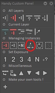

Theres a little tool that updates the instances with the same name after modyfing them, so if you have the frames named accordingly, then all you have to do is to click the Apply Current content on instances... tool under HANDY CUSTOM PANEL/ MANAGING INSTANCES/ Apply current contentTVPUSER wrote: ↑17 Aug 2022, 12:31You understand my plea Xavier!, Clip studio stores every unique frame as its own layer waiting to be pointed at.Xavier wrote: ↑17 Aug 2022, 08:01

Perhaps that can help in the meantime just as Takagi says...

Meanwhile what I do for this is a little script that duplicates the current layer which has the duplicated instances named accordingly (lineart for example) then clears all the heads, turning that layer into a ctg layer.Peter Wassink wrote: ↑19 Sep 2022, 11:17 This "link" information should remain intact when you duplicate a layer, so that when you make a duplicate layer for coloring you only have to color each unique original drawing,
The issue here is that once you turn that layer onto a CTG layer, the instance names are lost so you need to rename them manually to match the upper layer (im planning to do a script for this but for now it has to be done manually, the script for this should store the instance names as an array and then recall it for renaming the CTG layer)
After painting the stroke you can apply the INSTANCE TOO and it will put the same CTG strokes on any instances with the same name
In short:
1-Duplicate Lineart layer (With instances properly named)
2-Clear the heads of that new layer (while keeping the instances names and timing)
3-Convert into CTG
4-Rename Instances to match the lineart layer
5-Paint a stroke
6-Click on "Apply Current content on instances"
Hope it helps!
