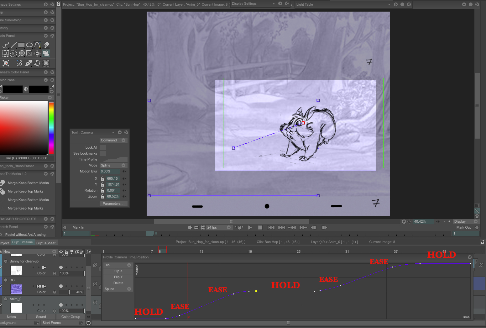

When I set up a camera move I stretch out the Camera Time Profile over the length of the scene, then set my start and stop points (for any HOLDS set a "flatline" section where the camera will stop , then start again). If I just scrub over the scene it always stays in camera view (as below) . Even if I press Play to watch it playback in real time it returns to this camera timeline view after playback is finished.

Thanks you David! Your QT unlocked the mystery. In the display drop down at bottom right I toggled on show camera. Now I can see what I'm doing. What does follow camera do?
