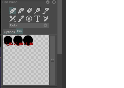

I confirm this bug on MacOS 12.5, TVPaint 11.7. I rename the brushes in the bin , them quit TVPaint , then later open TVPaint the customized brush names are gone and they only say "Brush".
Brushes named:

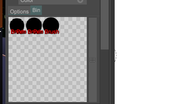

After closing and re-opening TVPaint the brush names have reverted to simply "Brush" -
