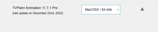

Re: macOS Monterey and TVPaint Animation 11 [UPDATE 17/06/2022]
The latest version of Monterey is 12.6.3 (that's the one I have). I believe the Codemeter installer that is contained in the TVPaint 11.7.1 installer (released on Dec. 22, 2022) is the correct installer.Holger wrote: ↑12 Feb 2023, 02:45 I just updated to Monterey and since TVP had trouble with the dongle I found this thread. I have now downloaded TVP again and have trouble installing it. I get an error saying that Apple can't verify that the software is secure. I also tried this advice from Thierry on page 1 , but the link does not open for me: UPDATE 17/06/2022: On macOS Monterey 12.4 (the latest one), TVPaint doesn't start because CodeMeter doesn't seem to be working.
If you updated to macOS Monterey, please install this version of CodeMeter and the software should be able to run once again: https://owncloud.tvpaint.com/index.php/ ... Sf5Zgj85lF
Could I get some help, please. Thanks in advance.
Make sure you have the Dec. 22,2022 release downloaded and reinstall Codemeter from that one, following these instructions for installation: viewtopic.php?t=14973
https://youtu.be/VjaiYmyVt2c
If you continue to get that message from Apple about how the software can not be opened because it is from an "unidentified developer", do this:
In the Finder on your Mac, locate the app you want to open.
Don’t use Launchpad to do this. Launchpad doesn’t allow you to access the shortcut menu.
Control-click the app icon, then choose Open from the shortcut menu.
Click Open.
The app is saved as an exception to your security settings, and you can open it in the future by double-clicking it just as you can any registered app.
Note: You can also grant an exception for a blocked app by clicking the Open Anyway button in the General pane of Security & Privacy preferences. This button is available for about an hour after you try to open the app. To change these preferences on your Mac, choose Apple menu > System Preferences, click Security & Privacy , then click General.
https://support.apple.com/guide/mac-hel ... 0/mac/12.0
