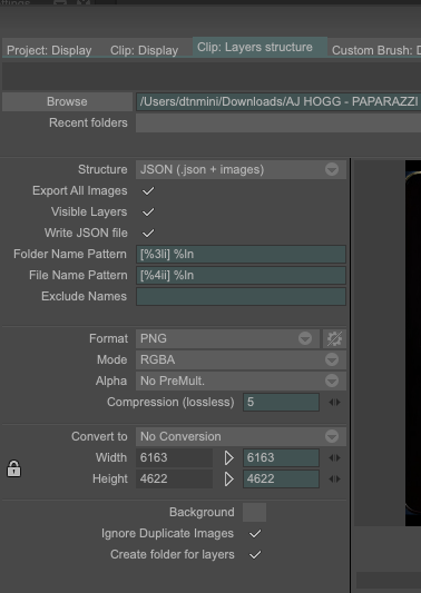

I exported a scene using Clip: Layers Structure> JSON . When I imported it into After Effects using the AE Import Script only about half of my layers were exported to AE (I double-checked to confirm that all of the layers are in the folder with the JSON file ... all layers are there in the folder, but for some reason many of the layers do not get imported to AE).
Here are my settings for export to JSON:
When I exported the same scene from TVPaint 11.5.3 using the same export settings (Ignore Duplicate Images checked) it imported into AE flawlessly, with all layers accounted for and everything in the correct place on the timeline. So I suspect this is a bug in 11.7. I haven't tried it with 11.7.1 yet because it is crashing too much and I have no time to waste because I have a deadline to hit today. The problem may be fixed in 11.7.1 (?) but I don't know . I'm not able to send you the file as it is a project under an NDA, so I can't share it. Based on this experience I suspect that there is a bug with the Clip: Layers Structure> JSON export and/or a problem with the AE Import Script. It works properly in 11.5.3, but does not work in 11.7.

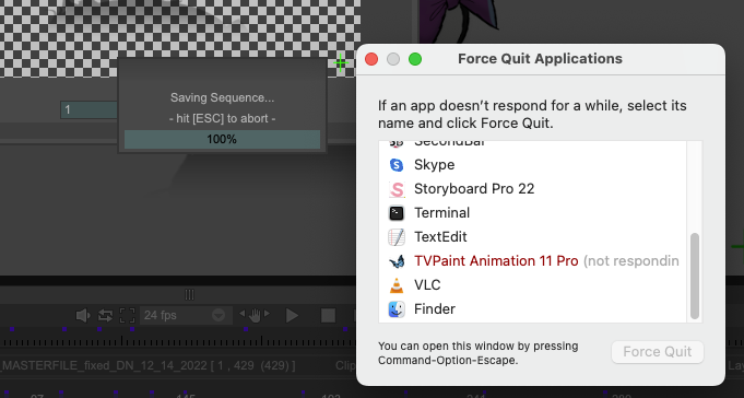

Trying again with export to JSON in 11.7. The progress bar gets to 100% ... and then it just sits there , the Saving Sequence progress bar never disappears , although it shows that the task is 100% completed. (this does not happen every time , but it has now happened three times, so it's often enough to warrant a report on this behavior). When I check on the status it shows TVPaint Animation 11 Pro not responding (frozen) . If I wait about 20 minutes it eventually unfreezes , but that's 20 precious minutes of lost work time. (yes, I realize I could be using the new TVPaint Convertor for this task while I continue to work in TVPaint , however that's another topic ... )
This Export-from-TVPaint-Import-to-After Effects function is so very useful , but it seems to have become unstable. I hope someone from the development team can take a close look at this to see if it can be made more reliable.
EDIT: After having this happen again today (progress bar for JSON export at 100% , but TVPaint is seemingly frozen , then unfreezes after waiting around 25 minutes) I am wondering if the problem is with the progress bar ? The progress bar advances to 100%, which leads the user to believe that the export has been completed ,but in fact the export process has not really finished yet and will take another 20 - 30 minutes to completely finish ? So the issue is that the progress bar needs to show a more accurate status of the export progress and not jump to 100% if the export is not actually finished yet.
EDIT #2- Indeed, I can confirm this behavior with the progress bar. I turned off all layers except for one layer. (the entire scene has 28 layers) This one layer has 145 images. I checked the box for export Visible Layers only. When I clicked on Export the progress bar only took about 30 seconds to reach 100%, but in fact the export of the 145 images took another 12 minutes to be completed. So there is a problem with the progress bar. It advances to 100% before the export process has completely finished.
