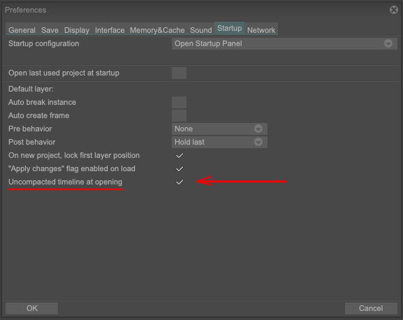

Also, in the new version 11.7.1 (released Dec. 22, 2022) there is an option in the Preferences to always open the scene with the Timeline expanded fully.
