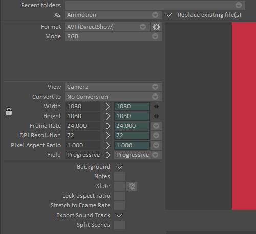

Hi
I am trying everything to export from the Camera View, but it just won't work. It has no problem exporting the Project View, but my camera work would not show this way.
For example, I have a project with around 2k resolution, but my camera is 1080x1080. I tried different animation formats, direct avi, internal avi, mov, mp4, etc. None of them works. It would export within a flash time and the movie file itself would just be a blank slate. Here is the setting I am using.
Please let me know if this is a common problem or just me. Thanks~
Z

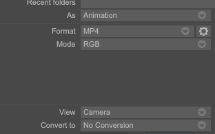

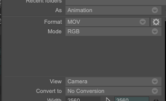

Re: Export From Camera View Fail
Try changing the AVI format to AVI Internal - Motion JPEG. Does that work ? What about MP4 or MOV ?
