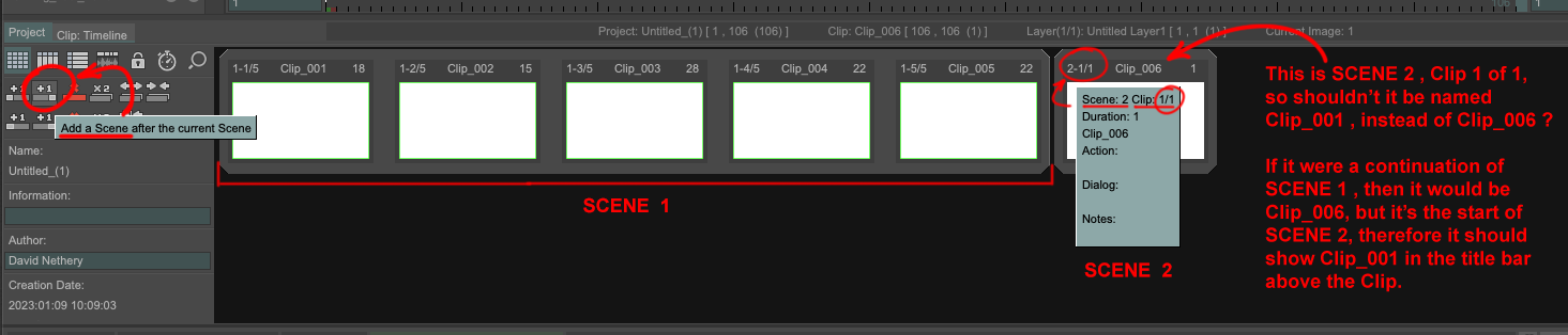

Here's another thought on improving the method of naming split clips:
What if splitting a clip automatically updates the numbering of all subsequent clips ? So let's say I have created SCENE 1 with 5 clips . The names are Clip_001, Clip_002, Clip_003, Clip_004, Clip_005. Now I split Clip_004 . The new split clip is named Clip_005 and the previously named Clip_005 automatically updates to Clip_006. So instead of renaming the new split clip as Clip_004_right it is named Clip_005 and the following clip ,Clip_005, updates to Clip_006. The updating of the clip number only occurs within clips that are part of the scene , so the clips in SCENE 1 that are split and renumbered do not renumber clips in SCENE 2 and subsequent scenes.
I think a problem is that TVPaint doesn't distinguish clearly enough between a "SCENE" vs. a "CLIP" . Practically speaking there are really only CLIPS in terms of the automatic naming convention.
For example , If I have SCENE 1 with 5 Clips (named Clip_001, Clip_002, Clip_003, Clip_004, Clip_005) if I then click on the button to Add A New Scene after Current Scene , it is named "Clip_006". But it isn't really Clip_006, is it ? It's Clip 1 of Scene 2, so it should be named Clip_001, because now it's the start of a new scene, SCENE_2. So with the creation of a new Scene the Clip Numbering should start over at 1. And in fact, it does actually do that in the panel naming info that is seen in the upper left corner of the panel. My new scene is labeled correctly there as 2-1/1 (Scene 2 , Clip 1 of 1) . But then why is Clip 1 named "Clip_006" in the main title bar of the clip ?

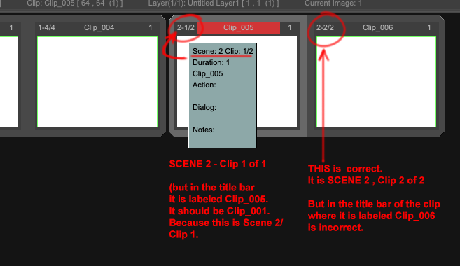

Peter Wassink wrote: 18 Jan 2023, 17:17 i also like Davids suggestion to start numbering clips from 1 for each new scene.
And in fact, this already exists (sort of), because if we hover our mouse over the upper left corner we see that when a new Scene is added the name is Scene 2-1/1 (Scene 2, Clip 1 of 1). It's just that the name which shows up in the title bar of the clip is inconsistent with the naming structure given to the new Scene/Clip. ( see attached screencapture movie )
