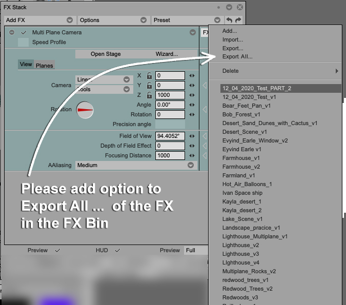

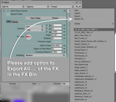

Option to EXPORT ALL FX in the FX Bin

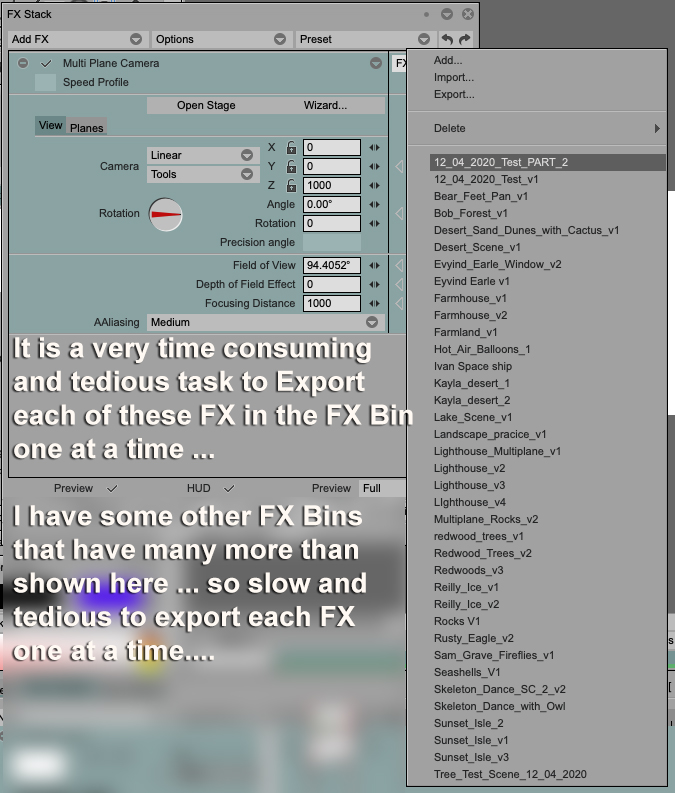

An option that would be very helpful is the ability to choose EXPORT ALL the FX in a particular category; for example, let us say that I have 100 KeyFramer FX saved in the FX bin and I need to Export all of those FX as a back-up (so I can re-load them later in a different configuration if necessary) or to share the FX with another user, it takes a considerable amount of time to export each of the 100 FX one at a time. The option to Export ALL FX in the FX Bin would be extremely useful.
(Also, as mentioned in another topic, when exporting a single FX , TVPaint needs to automatically assign the correct name of the FX being exported. As it is now the previously exported FX name is entered in the Export window , so the user must manually fix this each time by typing-in the correct name of the FX being exported. This is a minor annoyance if you only have one or two or thee FX to export , but if you have dozens or hundreds of saved FX bins to export it is very tedious.)

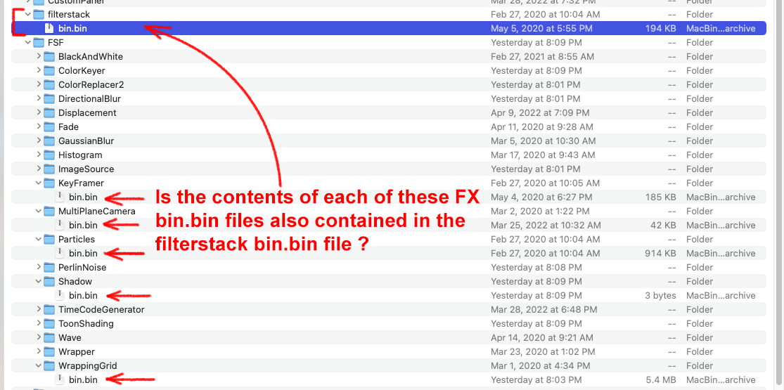

I guess I did not know that . So the file named bin.bin inside the filterstack folder is ALL the FX that have been saved into each of the FX Bins in a particular configuration of TVPaint ?
Screen Shot 2023-01-23 at 7.51.01 AM.png (16.5 KiB) Viewed 7422 times
My problem is I have saved FX scattered across various configurations of TVPaint that I have used over the years and I am currently trying to consolidate everything (all my custom brushes files, custom panels, FX stacks) into a single TVPaint configuration because I suspect that switching between my various configurations (some of which have duplicate .tvpx and .bin files) is the root cause of some strange issues I have been having. I'm trying to save everything I might need , but only have a single TVPaint configuration.
So, let's say a user has two Configurations: A and B . I wonder if it is possible to open Configuration A's filterstack bin.bin file in a text editor , copy the contents, and then paste the contents into Configuration B's filterstack bin.bin file , thereby combining the two FX bins ?
Yes it seems to work like this as far I know.
I just tried to copy and paste a couple of 'xxxx.bin' in the config folder and there are not available in the FX menu list after opening TVP again (I thought it would be the case since it 's the way TVP works), you will need to import them one at a time, so you're right it will be a hassle for a long list of presets...
