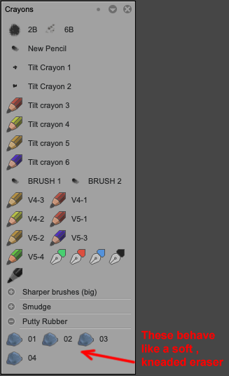

In this pencil set posted in the Contents Sharing forum there are four "kneaded erasers" that will do what you want. viewtopic.php?p=99263
File is Crayons.tvpx
