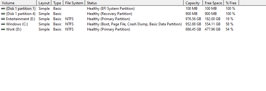

Could you post screenshots of the "properties" windows of your different drives, please?

Here they are,all NTFS format
WeChat Screenshot_20230125153729.png (15.28 KiB) Viewed 3190 times
