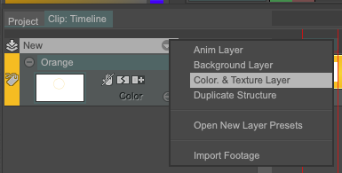

Being new to TVpaint, I am not aware of CTG capabilities, but I should find out, I might like it. So I wouldn't have it if I didn't specifically ask for it. The texture brushes that are available do not automatically make a CTG layer? Or does it?
Re: camera moves and import high rez BG's
JoeMurray wrote: 10 Feb 2023, 15:30 Being new to TVpaint, I am not aware of CTG capabilities, but I should find out, I might like it. So I wouldn't have it if I didn't specifically ask for it. The texture brushes that are available do not automatically make a CTG layer? Or does it?
No, a standard brush that has texture won't automatically make a CTG layer. You have to intentionally create a CTG layer from the New Layer menu.

I should note that they changed the name from Color & Texture Generator Layer (CTG) to Color & Texture Layer (CTL) as of version 11.7, but I'm so used to referring to it as CTG that I haven't got in the habit of saying or writing CTL. In version 11.5 and before it is still CTG.
Read all about it starting here: https://www.tvpaint.com/doc/tvp11/index ... l-concepts or these video tutorials about using CTG:
