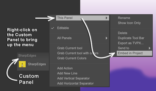

When you make a custom panel it will always be saved inside the current configuration. If you want to make sure that a specific custom panel will always be part of a TVPaint project file that you will be sharing with others, right-click on the custom panel and from the menu select This Panel > Embed in Project .

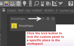

If you want the custom panel to be stuck to a specific place in your workspace (say in the upper left corner of the workspace, click the lock button to lock it in place.
