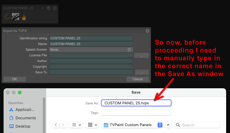

These screenshots show what happens when saving the Custom Panel as TVPX:
Let's say I create a new Custom Panel and I give it the name Custom Panel 25. Then I click on Export as TVPX .

Then click Save To ... to set the location where the TVPX file will be saved.

But when the Save As window opens there is a problem. The name of the file is the name of whatever file I had previously saved , instead of being assigned the name of the current file I'm saving.

So now I must stop and manually type in the correct name before saving it. The expected behavior is that TVPaint will automatically assign the name of the Custom Panel being saved , instead of the name of the previously saved file. (this bug exists going back to at least version 11.5 and has been reported before).

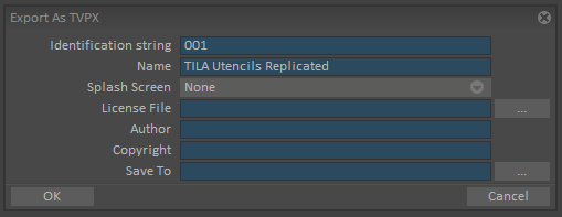

Can you give me more details about the way you are exporting the Custom Panel? How is the tvpx file named, does it have special character in the filename?
If you could post a screenshot of the Custom Panel's export window, that would be great.
I have seen this bug in the past, and I have tried to replicate it, but I was never able to find the trigger condition.

Thierry wrote: 08 Mar 2023, 10:05 Hello,
I have found on an older computer the exact same custom panel running on TVP Version 11.5 with the originally effected brushes, and have imported them again into my current PC using TVP 11.7, yet this time, every single brush works absolutely fine... I'm lost for words in all honesty. The brushes originally effected had no special characters for names, nor anything special in paper texture - using the cement texture. I have attached the TVPX for you to experiment with as this only occurred when I used version 11.7 - perhaps going duff once TVP updated. Mind you I hadn't used the effected brushes for an extremely long time until I came across the issues recently. I have since taken them off my workflow, but regardless, I hope something can be found here.
As for the Export setting, it was its default. No special characters.
