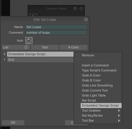

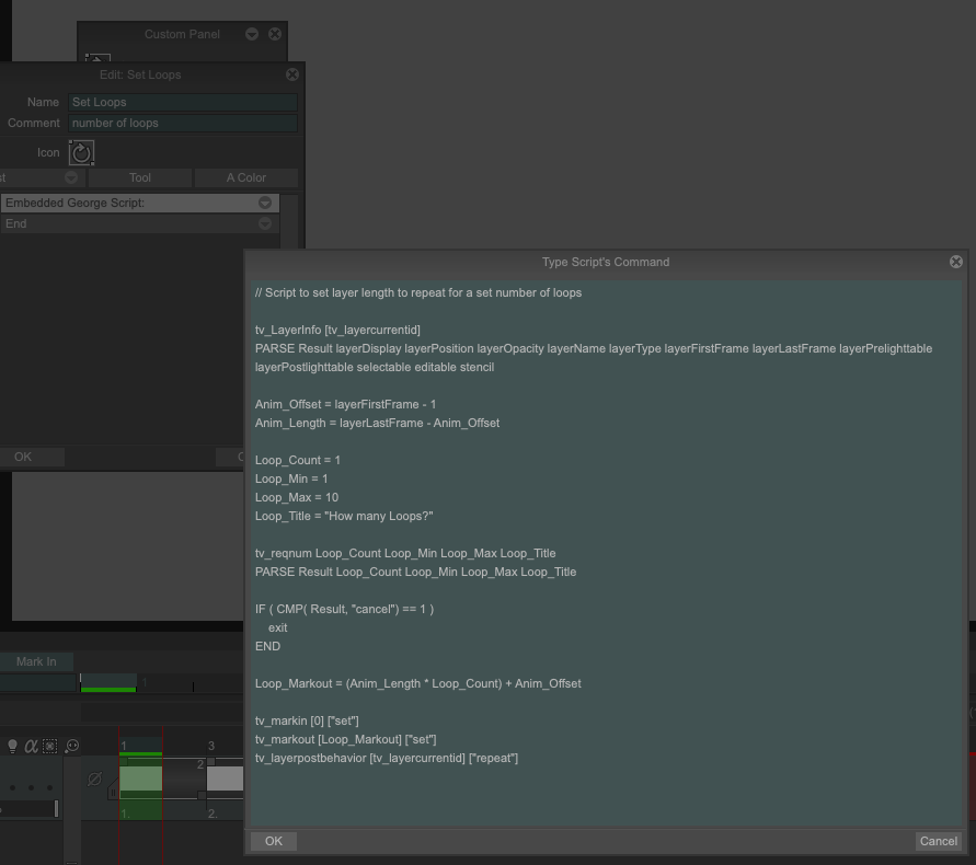

To add to this: First make a new Custom Panel , from menu Custom Panels > New Custom Panel.
OR add an action to a current custom panl. Then right-click on it to Edit. From the menu select Embedded George Script.
Copy and Paste the George Script into the window that opens up. Click OK.
So now when you press the button in your Custom Panel the embedded script will run.
This one will ask you how many times you want the selected layer to loop. It will automatically set the Mark-In and Mark-Out based on how
many times the animation should loop.
Edit the Custom Panel.png (12.02 KiB) Viewed 31344 times
Set Embedded George Script.png (31.81 KiB) Viewed 31344 times
Paste the George Script.png (83.62 KiB) Viewed 31344 times
