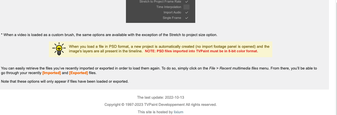

It seem that this information should also be added to the User Guide in the section on Importing files to TVPaint.
Screen Shot 2023-03-24 at 8.25.28 AM.png (47.23 KiB) Viewed 4329 times
