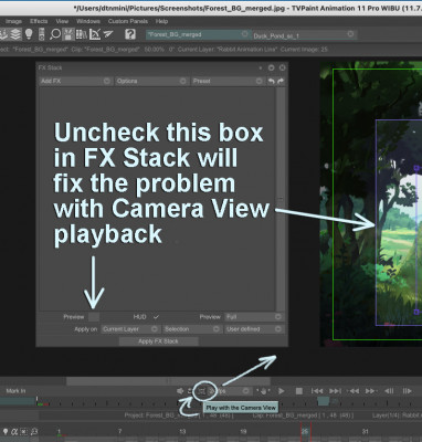

Re: TVP cannot show the Camera preview and Force proxy render
Dean wrote: 14 Apr 2023, 14:21 I really meant the FX stack, we have recently found that this thing is linked to the camera view playback issue (it was mentioned on another thread, I think).
Ok.
And now I've had time to test it. Yes, uncheck the box next to Preview in the FX Stack to fix Camera View playback issue ! Very interesting.
I would never have guessed that the FX Stack Preview had anything to do with the Camera tool. How did you ever discover the connection ?
Apparently you only have to uncheck the Preview box in FX Stack one time , because I noticed when the FX Stack is closed and reopened the Preview is checked again,
but unchecking it one time fixed the problem with the Camera View playback.
