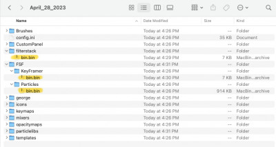

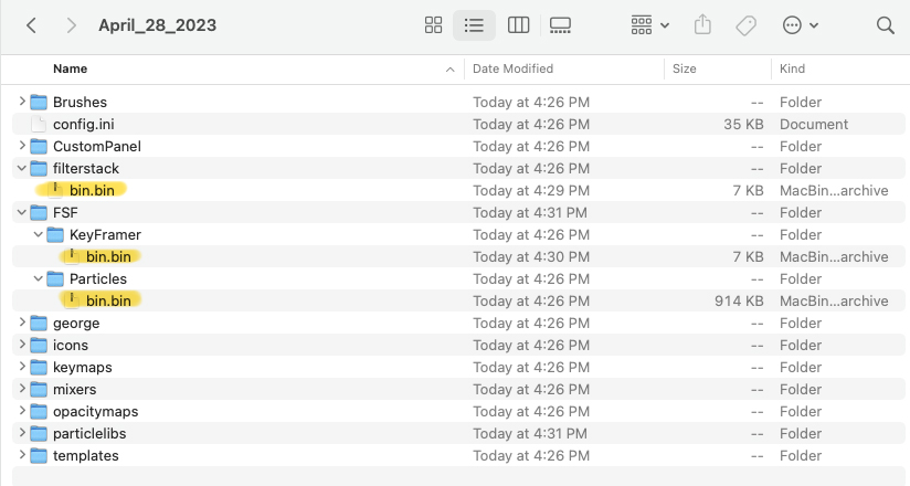

I created a fresh config , but I'm still seeing the FX Bin files displayed with name "bin.bin" .
How is it supposed to work to have FX bins saved with their proper names (for example: Keyframer.bin , Color Adjust.bin , Blur.bin , Particles.bin) instead of the repetitive "bin.bin".

Could you let us know if you are exporting your bins to those folders specifically (it seems you are within TVPaint's config folder there)?
Those bins are automatically created within this folder on macOS upon exporting a FX bin. The "bin.bin" name will be used there, even if the chosen exported name was different. This seems to be old code and the developers are currently investigating this to understand why this creation of such duplicates happens in the first place.
I can confirm that the FX bin naming works with a fresh config on my end. However, if you change the default name to something else, TVPaint will remember the last name you entered and use this in place of the default effect's name afterwards.
We are currently discussing this with the developers, as I think removing this "remember last used name" feature would be better when one seeks to export FX bins.

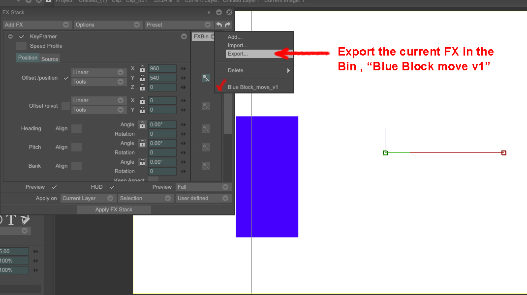

Here is how it now works for me when exporting an FX from the bin in 11.7.1 (hotfix April 28, 2023) -
Current FX in the bin is Blue Block move v1. Click on Export.

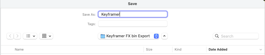

When the Save As window opens for the first time the FX name is "Keyframer". I must manually change this to the name of the current FX I am exporting: "Blue Block move v1"

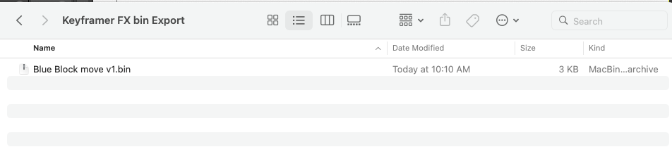

Then the final result is this:
However, if I want to export another FX in the Bin , this one named "Blue Block move v2" when I click on Export the name in the Save As window is "Blue Block move v1" (the previously exported FX) , but it seems like it should be the current FX that is being exported ( "Blue Block move v2" ) instead of having to manually change the name each time.
This also happens when I move to a different FX Stack category , such as Distortion > Warp Grid. If I have a saved FX in the Warp Grid bin called "Warp Grid Yellow Box v1" and I click on Export , the name in the Save As window is the previously exported FX (from the KeyFramer bin) called "Blue Block move v2" .

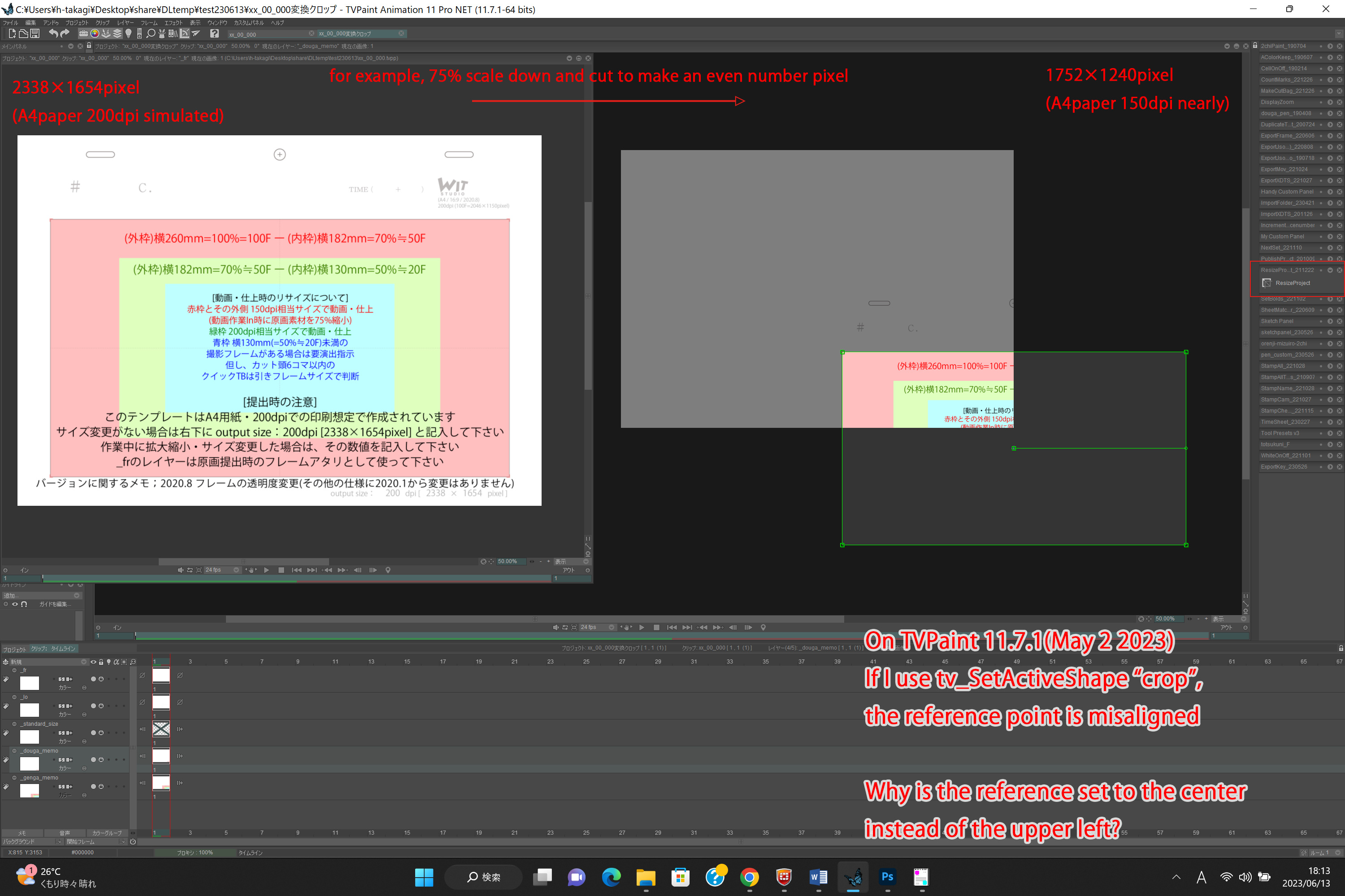

Hello, Theirry.
Due to my circumstances, the communication was delayed.
I would like to inform you about the results of the tv_SetActiveShape "crop" I requested, but it did not improve.
I will send you the execution image and the code of the script I am using. This content worked fine up to 11.5.x.
