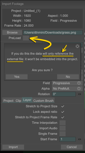

When we import a source image into TVPaint if we uncheck the Preload box we get a message telling us:
"If you do this the data will only reference the external file: it won't be embedded into the project."
In some other applications that make use of referenced images, such as Adobe After Effects, Adobe Animate, Storyboarder (to name a few) , if I edit and save an external referenced image
it will be updated in the project where it is being referenced. (for example if the original referenced image is a red ball, but I edit the original referenced image to adjust the hue & saturation to make it a yellow ball and save it , then inside the app where the image of the red ball is being used it will update to be a yellow ball.)
However, in TVPaint a referenced external file is not updated if the original referenced file is updated. It makes me wonder: in what sense is the external file a "referenced" image ?
It seems to behave the same as a non-referenced image that was imported into TVPaint. To update the image it must be re-imported to a new layer and the previous layer deleted.
My feature request:
Would it be possible to have external referenced image files be updated in TVPaint if the original referenced image is edited ?
Under the Project menu > Dependencies we have the option to "Reload All Soundtracks". If I have a soundtrack loaded in TVPaint , but I edit the original soundtrack file , then when I click "Reload All Soundtracks" it automatically updates the soundtrack in TVPaint. So could we also have "Reload All External Image/Video Dependencies" under the Project menu > Dependencies ?

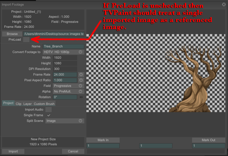

Previously I had been trying it with single images (painted layers from Photoshop to be used for a multiplane camera set up.) So when I imported those single images one layer at a time into TVPaint with Preload unchecked I expected those images to behave as referenced source images , therefore I expected that if I make any changes to those referenced source images then the changes will be seen in TVPaint. But that did not work.
Just now I have tried another test with one of my painted layers ,Tree_Branch_OL.png.
I imported it to TVPaint with Preload unchecked. Then I made a change to the original source file Tree_Branch_OL.png . But the change does not show in TVPaint. Same results as before ...
Next, I made a copy of the image and named the two images Tree_Branch__OL_0001.png and Tree Branch_0002_OL.png. Then I imported those into TVPaint (with Preload unchecked). I edited the original source image Tree Branch_0002_OL.png in Photoshop and saved it. When I went back to TVPaint the image had updated to show the changes I made on the original source image, Tree Branch_0002_OL.png.
BUT, then I tried editing the first image on the timeline ,Tree_Branch__OL_0001.png, and it also updated in TVPaint!
So it seems as if TVPaint will treat an imported image sequence as referenced source images , but will not treat a single imported image as a referenced source image.
The feature request is that TVPaint would treat a single image (imported with Preload unchecked ) as a referenced image which may be edited and updated (the same as an imported image sequence).
