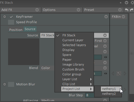

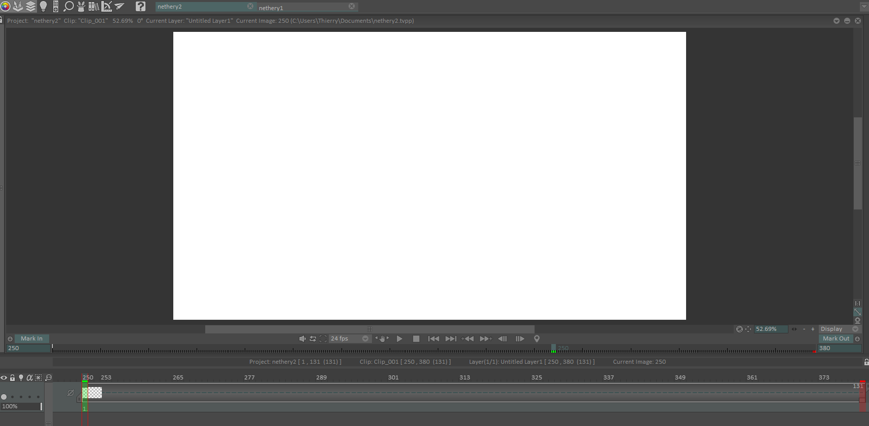

Here is an issue with the KeyFramer FX that I hope can be improved:
1.) I have one project open with animation that starts at frame 250 and ends at frame 380. Mark In set to 250 , Mark Out set to 380. This Project #1 is my source project.
2.) In my second project I have also set the Mark In frame at 250 and Mark Out at 380. I've created a blank layer running from frame 250 - 380.
In the FX Stack > KeyFramer I set the Source to Project #1 , but the frames of animation from the source project do not show up at frame 250 - 280,
instead the source frames show up on frame 1 - 130. This is annoying because I have to drag my blank layer over to the left of the timeline to start at frame 1,
then run the Keyframer to apply the source frames to the layer , then drag the layer back over to the right to start at frame 250. But why is this?
Both projects are set with the same Mark In frame. The source animation starts at frame 250 and my blank layer in the second project starts at frame 250.
So one would expect that the Keyframer would place the frames from the source project to start at frame 250 in the destination project. Can this be fixed ?

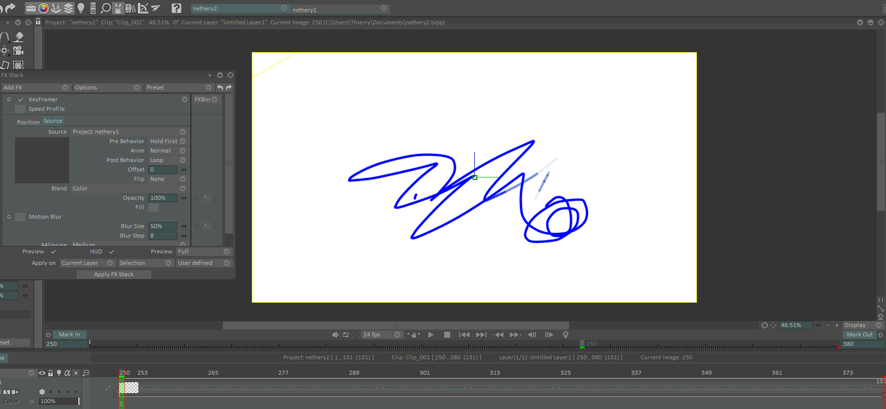

I've run a test, and I don't have the behavior you're describing.
I have one project, like this:
Mark in at 250, Mark Out at 380, a (very) basic animation on it.
I have another project, like this:
Same Mark In/Out, but an empty layer.
Basically I tried to have the same environment as your original post.
So, next I go in the FX Stack, select the Keyframer:
And I instantly have the animation that starts "playing" at frame 250:
I'm not sure why you don't have this on your side, assuming we both made the same steps.

Here is what happens on my end:

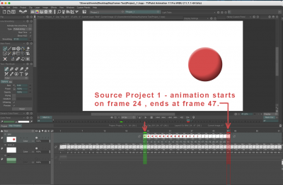

Project 1 (source project) -
Animation starts at frame 24 and ends at frame 47. Mark-In = 24 , Mark-out = 47
Project 2 -

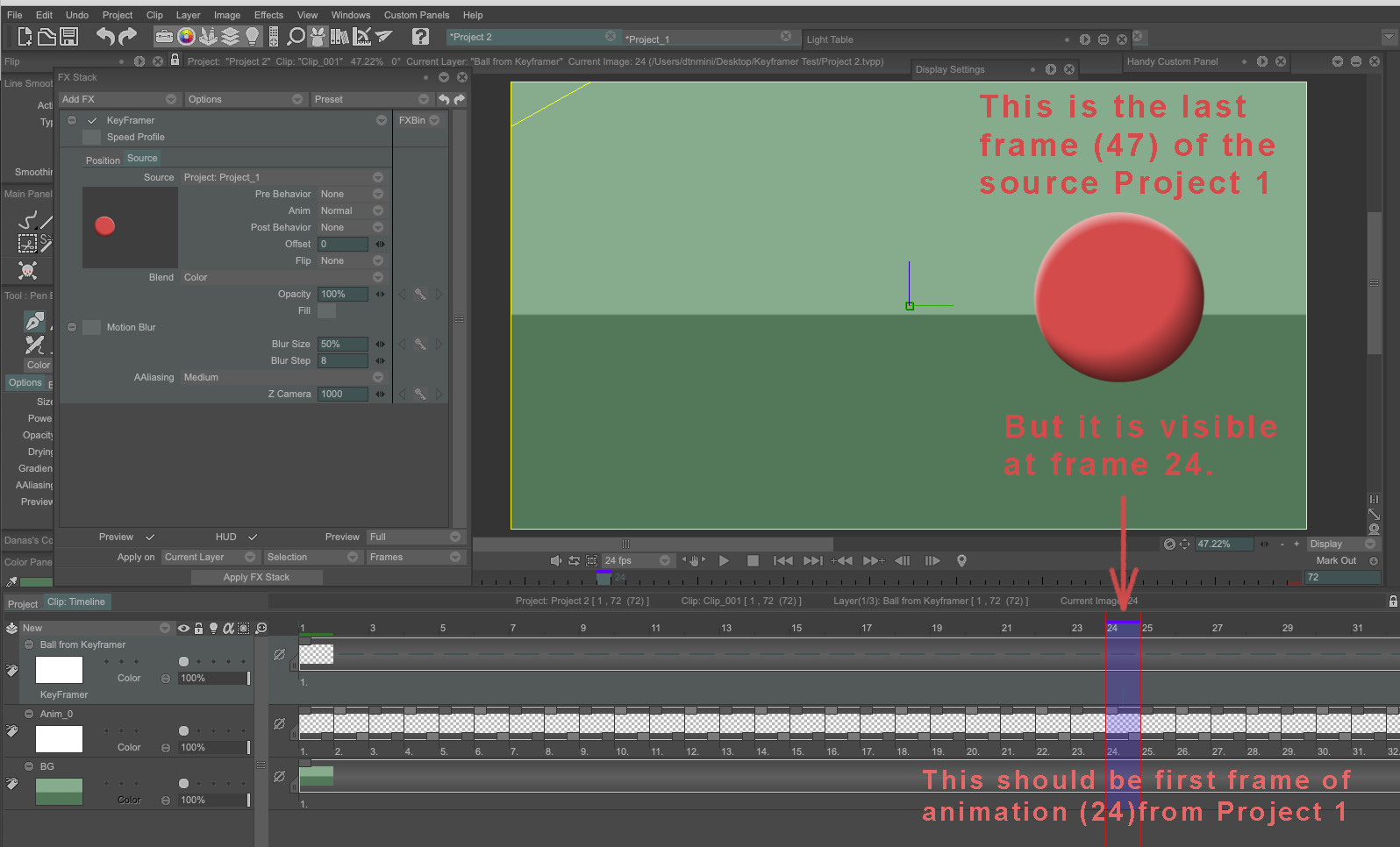

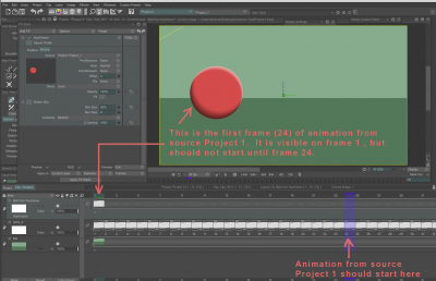

Set Keyframer source to Project 1. The intent is that the animation should start at frame 24 and end at frame 47. But in the screenshot notice that frame 24 of Project 2 shows the last frame (47) of the animation from source Project 1. Then go to frame 1 of Project 2 , notice it shows the first frame (24) of the animation from source Project 1. But the intention is that the animation from source Project 1 will start on frame 24 of Project 2 instead of starting on frame 1.
So the Keyframer does not keep the Mark-In point (frame 24) of the animation in the source project. It places the source project animation to start at frame 1 , not at frame 24.
Also see the attached movie to see what I'm seeing on my end.

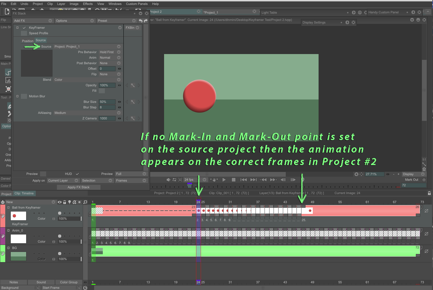

The solution seems to be to turn off the Mark-In and Mark-Out points on the source Project. When I try the same test again, this time turning off the Mark-In / Mark-out points on Project 1 , the animation starts on the correct frame in Project 2 .
So there is a simple workaround , but it is my experience that the Keyframer does not "see" the Mark-In and Mark-Out points on a source project.
My .tvpp Project 1 (source) and Project 2 are attached. Try it (with Mark-In and Mark-Out set on the source Project 1) and see if you get the same results I reported above.
If you do not get the same results , then is it possible that this is a Mac version bug ? (I'm assuming you ran your test on Windows , but do you get the same results on a Mac?).
