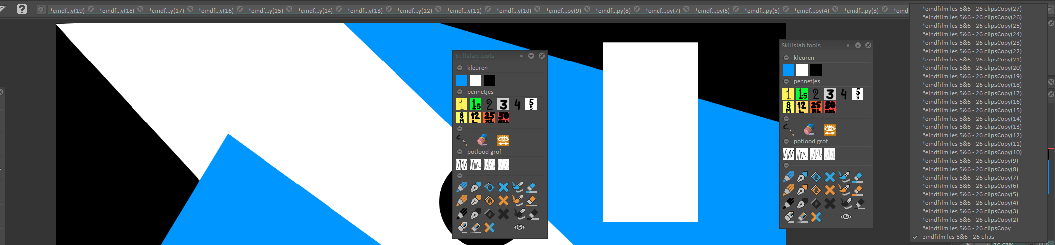

is there a way to save all opened projects easily?
Is there a way to close projects simply? i think i recall we used to have all openend projects visible as a list under windows.
this is not particularly pretty or handy.
neither is this:
Screenshot 2023-06-07 155823.png (3.24 KiB) Viewed 4891 times
its silly looking...but this was addressed recently i believe?
Re: spliting a project
Peter Wassink wrote: 07 Jun 2023, 13:56 is there a way to save all opened projects easily?
neither is this:
Unfortunately I don't think there is a way to save all the opened projects easily , all in one go. You have to click on each opened project and Save. One at a time ...
I wonder if someone (Svengali or Mads or Nathan) has come up with a script for Save All Opened Projects. This seems like it should be a new feature request. A "Save All Open Projects" in the menu should be built in. (or maybe in the TVPaint Converter ?)
