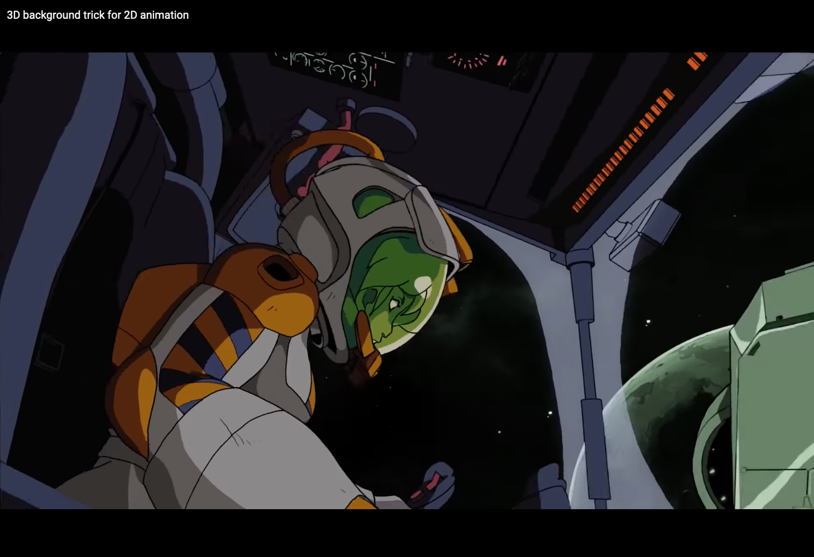

Thanks for the list of tricks to keep the file size smaller.
With CG animation it will help to render it with no lighting or fill, just line drawings, as Paul Johnson shows in these videos:
https://www.youtube.com/watch?v=8ybavUT9dNg
https://www.youtube.com/watch?v=MMUcafde5A4
Paul (who uses TVPaint for his character animation) does the animation of the spaceships in Cinema 4D , then renders it with the "Toon Filter" to render it as black and white lines only, then imports the image sequence to TVPaint, where the black and white line layers can be scan cleaned, making them very light. Then he can draw his characters interacting with the CG animation layers.
