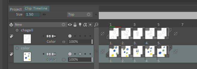

Posts: 4517
Re: Coloring "rough" drawings-Open lines all over
good news...
those are perfectly neat lines!
With this line quality, using the method i described, coloring the whole animation white can be done in mere seconds.
Not exaggerating!
Then use alpha lock on he white layer and color there.
Or... if you want to keep the white, activate stencil mask on the white layer and color on a separate layer above it.
color stencil.png (64.56 KiB) Viewed 9308 times
