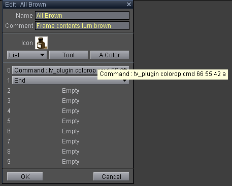

do you need to modify only the "Ink All in Black" into a custom "Ink All in Brown" tool ?
or will you need all the "Black" relative tools to be modified as well,
(Erase Black Pixels, Tint in Black, Magic Black Eraser) ?
anyway, you can start to try this : duplicate the "All in Black" Button,
then edit it and replace the command line by the one as on this attached pict. :
LMB click "Type Script's Command..."
ps : An other way consists to "buttonize" an FXstack,
I haven't tried this, but I think it should be possible after some FXs tweaking.
- AllBrownButton.png (7.81 KiB) Viewed 16179 times

Re: how to customize the color of the "all black" ink pot?
Hi Zigotto,
sorry for my late reply. I just realized that I haven't gave you feedback yet.
Yes, your recommended script does exactly what I need.
Thank you very much again,
vera
