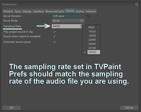

You probably already know this, but the first thing to check is if TVPaint's sound preferences sampling rate is set to the same sampling rate as the audio file you are using. If the audio file is 48000Hz then TVPaint should also be set to 48000Hz . (or 44100Hz or whatever it may be ...)
TVPaint audio sampling rate.png (25.53 KiB) Viewed 10316 times

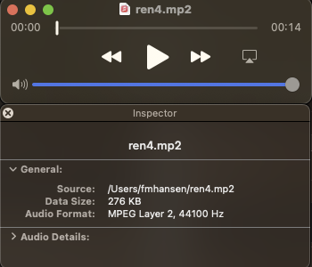

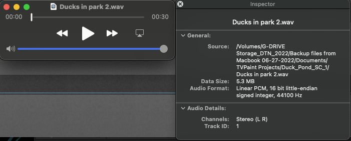

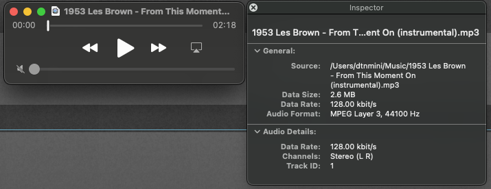

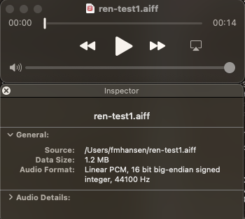

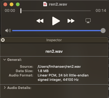

I'm sorry to read that you're still having the problem with the audio crackle . I have tried to reproduce this problem by using a variety of different .wav and .mp3 files , but I can't reproduce the issue on my end. In your case , do you experience the crackling playback problem with every type of audio file that you use (.wav, .mp3, .m4v, etc.) or only with a specific type of audio file that has the crackling issue ? What do the settings look like on your audio file(s) ? I know you said yours is 44100 Hz , but can you post a screenshot of the other audio parameters ? For example:

Attached are screenshots of the 4 audio files I tried using. Each one had a crackle/pop in TVP timeline playback. Although this issue started a while ago not sure what started it. Could have been my upgrade to 11.7.1
