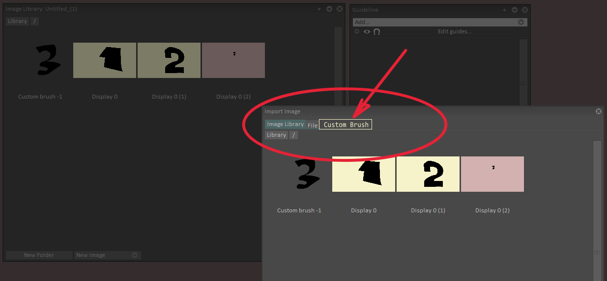

if you want to be able to interact with the guideline image you could consider simply enlarging (cropping) the canvas to have the image sit inside the project.
i believe a request for an infinite canvas, which is a cool concept... is definitely not gonna happen with TVPaint anytime soon.
If you simply want to improve the flexibility of putting images/custombrushes/screenshots up as guidelines, this i would find a very valid request,
Having to use The image library, is cumbersome, one needs to go through a couple of unnecessary hoops in order to put up an image as a guideline.
i think something that would allow you to directly put up the current custombrush as a guideline would help ease the workflow...
maybe this could be achieved with an extra tab on the guideline image requester (see image)
tvp - library.png (34.3 KiB) Viewed 2146 times
