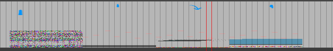

On Mac - no crash, but glitches terribly - see screenshot:
Screenshot 2023-10-11 at 20.16.12.png (25.38 KiB) Viewed 4146 times

To add to my previous message: a student experienced a crash every time she uses the Note panel and the Interactive Zoom tool in the Timeline window. She's working on a Mac Studio similar to the one mentioned above.
We've tested the file on an IMac with an Intel processor (Quad-Core Intel Core i7, 16Gig RAM, Mac OS 11.7.3) and the problem is the same: the crash can be easily reproduced.
