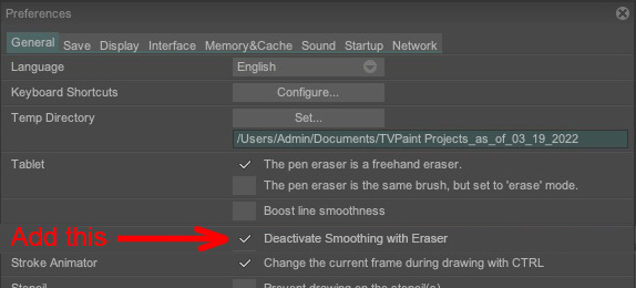

Is disabling line smoothing when the eraser is activated doable ? Perhaps as a check-box option in Preferences ?
Deactivate Line Smoothing with Eraser in TVPaint copy.jpg (74.67 KiB) Viewed 11439 times
