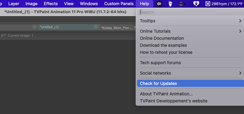

Under the HELP menu you can Check For Updates.

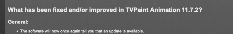

And one of the features that should be working again now in 11.7.2 is that the software will give you a pop-up alert when an update is available.
