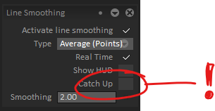

I did a quick test with the 11.7.2 update and it looks that this issue is gone now, except when I use these settings in the Line Smoothing panel with 'Catch Up' marked ON.
Apart from that everything seems to work as it should.
