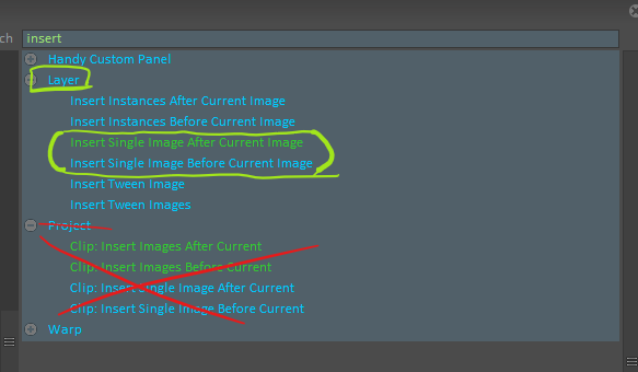

In the shortcuts menu:
LAYER - Insert SINGLE Image After Current Image. No pop up, adds images to current layer only, for as many times as you press the key
Screenshot shortcuts menu.png (27.73 KiB) Viewed 2355 times
Elena C wrote: 27 Jan 2024, 13:57 I'm using either the I shortcut or Right Click>Insert image>Append image after.
Right clicking to add images is the same as using "Insert Instances After/Before Current Image" action which prompts the pop-message.
The devs set the default action for the "I" key to " PROJECT - Insert Images..." which is why it adds images to all layers in the current clip in the project instead of just the layer. So if you're already accustomed to using this key you can just change it to Layer >Insert Single Image After Current Image

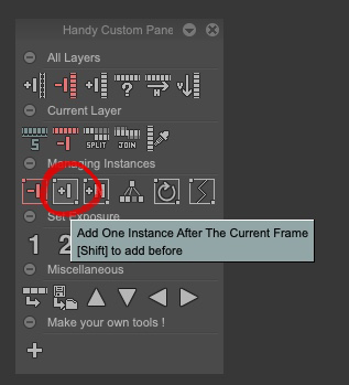

To add to Cardin's post above, you can also do this from the Handy Panel > Managing Instances > +1 .
