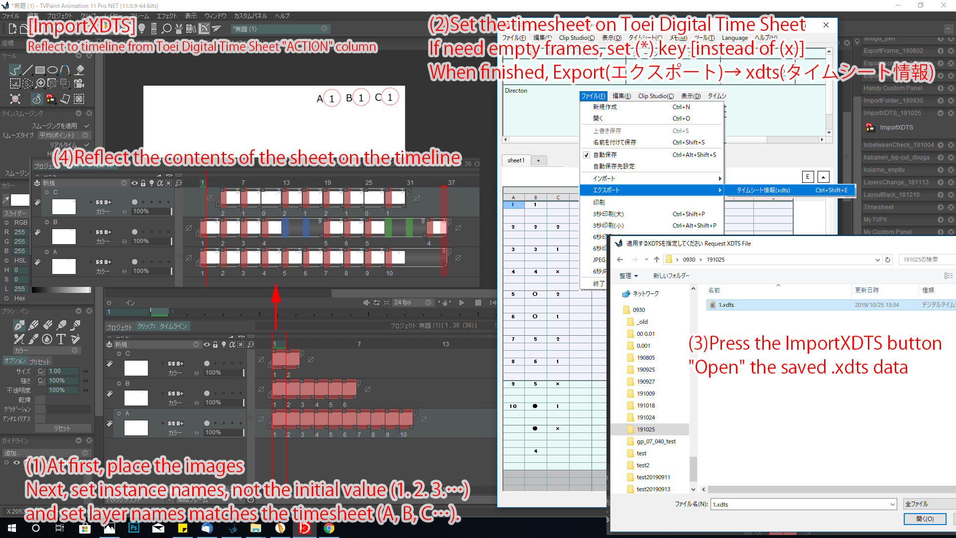

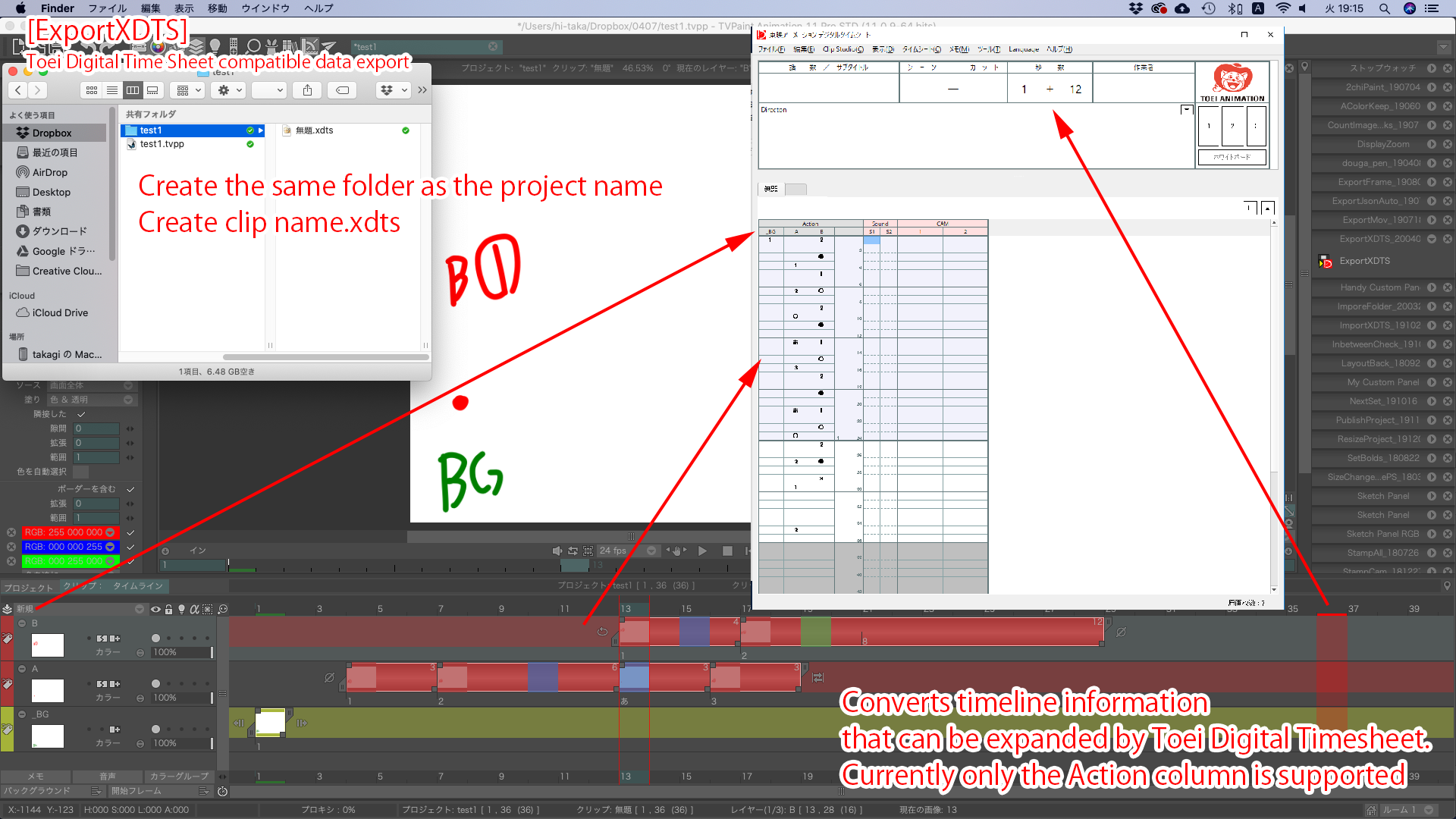

The custom panel of "Import/Export XDTS", which has been talked about, is released here.
[20/06/17 added]
This panels reads/writes JSON data (.xdts) that transfers timeline data to Toei Digital Animation Sheet (Windows Application)
developed by Toei Animation and published by Celsys.
ExportXDTS.tvpx updated at 20/06/16 on Japanese Forum.
I set the latest 200608 edition.
Import/Export XDTS Panel

- ExportXDTS_200608.tvpx
- (72.5 KiB) Downloaded 1454 times
- ImportXDTS_200415.tvpx
- (73.5 KiB) Downloaded 1426 times
