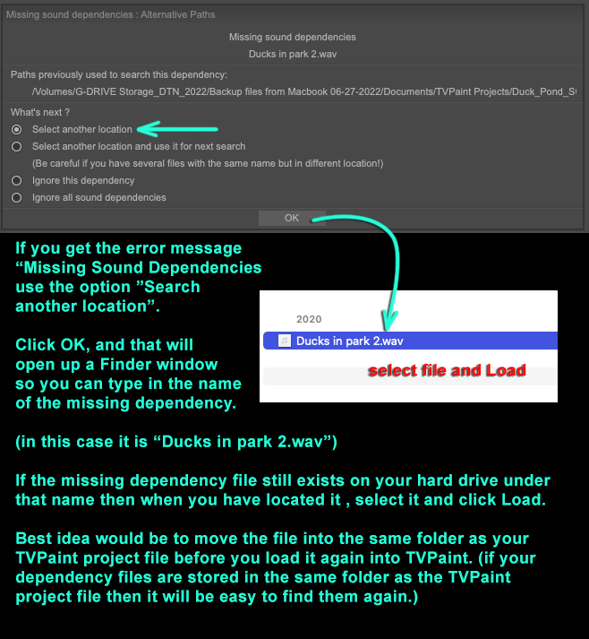

Usually if a dependency can not be found it's because the dependency file got moved to another location on the computer. (or the file was renamed)
So for example, if an audio file was formerly on your Desktop , but you moved the audio file to a different location on your computer , TVPaint is going to be looking for the
path to that audio file that was formerly located on the Desktop, but because the file has been moved TVPaint can't locate it.
When you get the error message saying that a dependency can't be found , select another location to search for it on your computer , then when you find it you can reselect the file to reload it into TVPaint (if you can't find the missing sound dependency then that means the file was deleted or the name of the file was changed.)
(click on image to view it full size)
As a rule I try to keep all my source files (dependencies) in the same folder with the .tvpp project file so it doesn't have any trouble locating it.

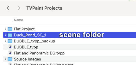

I have one master folder on my hard drive in the Documents folder named TVPaint Projects.
Each TVPaint Project has separate folder .png (19.55 KiB) Viewed 6914 times
Inside of the TVPaint Projects folder there are all my various TVPaint projects , each within it's own scene folder.
All of the source files (dependencies) , including audio files , are stored in that same scene folder.
Source Files reside in same folder as TVPaint project.png (70.92 KiB) Viewed 6914 times
These source files are never moved outside of the TVPaint project folder, so the path to those dependencies may always be found by TVPaint.

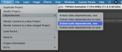

Also , you have the option under the Project Menu > Dependencies to Embed audio dependencies. If you choose Embed audio dependencies then the audio file(s) should be embedded within the project file. This should prevent any audio file dependencies from being lost.

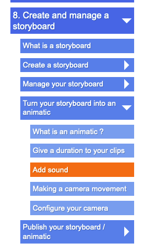

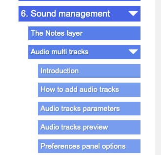

See Section 6 in the User Manual on Sound Management > Audio multi tracks and also Section 8 on Create and Manage a Storyboard > Turn your Storyboard into an Animatic > Add Sound.
https://www.tvpaint.com/doc/tvp11/index ... -add-audio
